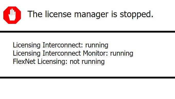

SubscriberHi, so I'm trying to use STK evaluation license but my FlexNet licensing does not worked. When I open the Debug Log it said I need to kill "lmrg.exe" mannually, but lmrg.exe is not currently running on my computer. I tried to refresh the Debug Log and remains firm that I need to kill this non-running program.Â
Any help would be appreciated,Â
Thanks in advance!

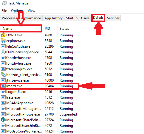

If you got to Task Manager->Details tab…
Sort by Name.Does lmgrd.exe appear? Make sure this is the ANSYS lmgrd.exe if you have multiple Flexlm installed)
Right-Click on it and choose End TaskIf it does not, try the following:

21:57:56 (lmgrd) Using license file "C:\Program Files\ANSYS Inc\Shared Files\Licensing\license_files\ansyslmd.lic"
21:57:56 (lmgrd) Unable to kill lmgrd.exe. Â Please kill this manually by opening the Task manager and Killing the lmgrd.exe which are still running".And these are the tasklist. Please excuse my very messy tasklist.
