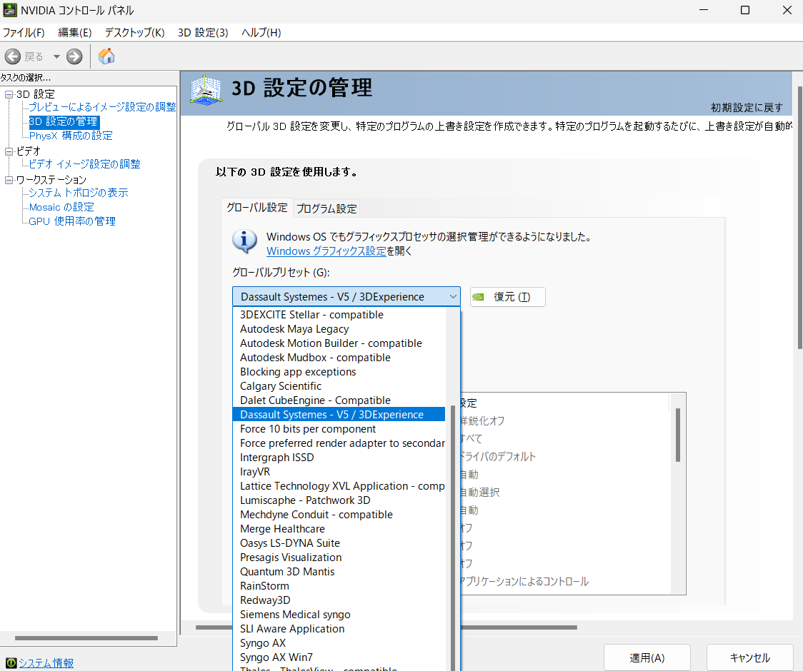

Ansys EmployeeMake sure you are using the Graphics Cards listed in Platform Support.Please update your graphics driver to the latest version.If the symptoms still persist, open the NVIDIA Control Panel, go to Manage 3D Settings > Global Presets and change the Base Profile to “ Dassault Systemes - V5 / 3DExperience ”, reboot the device and make sure the settings are in the same state as they were after the change before operating AEDT. Please try to operate AEDT after restarting the terminal and confirming that the settings have been changed. -

SubscriberThank you so much. The issue resolved by applying the above techniques.
