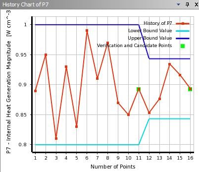

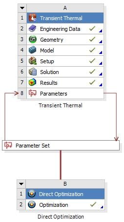

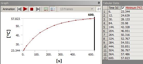

      Transient Thermal Optimization Example Model

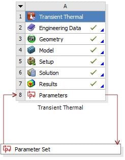

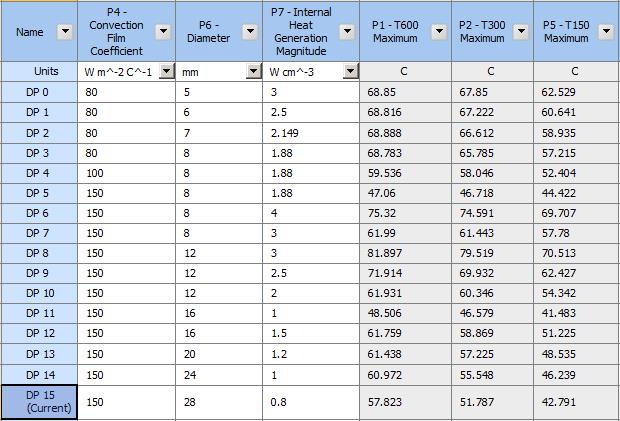

      I created a very simple model that you can play with to learn some of the capabilities of ANSYS Design Optimization. It is just a circular wire with a parameter for the diameter, the wire body has an internal heat generation parameter and a heat transfer film coefficient parameter. It solves in 4 seconds and I can plot the time history of the surface temperature.
      When you add parameters to an ANSYS model, you get a Parameter Set block in the Project Schematic.
      That lets you easily type in values and solve that model in a table format. Below are 16 trials where I just typed in the values I was interested in and clicked Update.
      You provided some experimentally measured values.
      If I take the temperature at 150 s = 46 C, 300 s = 54 C and 600 s = 62 C as target values, I can try to adjust the available parameters to match those targets.

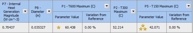

      An observation was that the Internal Heat Generation was a good parameter to adjust to get T600 to hit a target value of 62 C. I can do that by trial and error (or manually apply a bisection algorithm), or I can add a Direct Optimization block to the system.
      Then I can tell ANSYS to search for the value of Internal Heat Generation that satisfies the objective that T600 = 62 C and it automatically searches, solving the problem 16 times to arrive at the value.
      While that value satisfies T=600 target of 62 C, the T=150 value is 45.2 C so does not satisfy the target of 42 C, and that is where a two parameter optimization can be employed to vary the diameter and the internal heat to satisfy two objectives.
      With two objectives, it has brought the T150 temperature on target, though the T600 has drifted off somewhat.
      I hope these examples give you a taste for what is possible. There are many other tools in the Design Exploration toolbox, so I hope you try these out on your project.

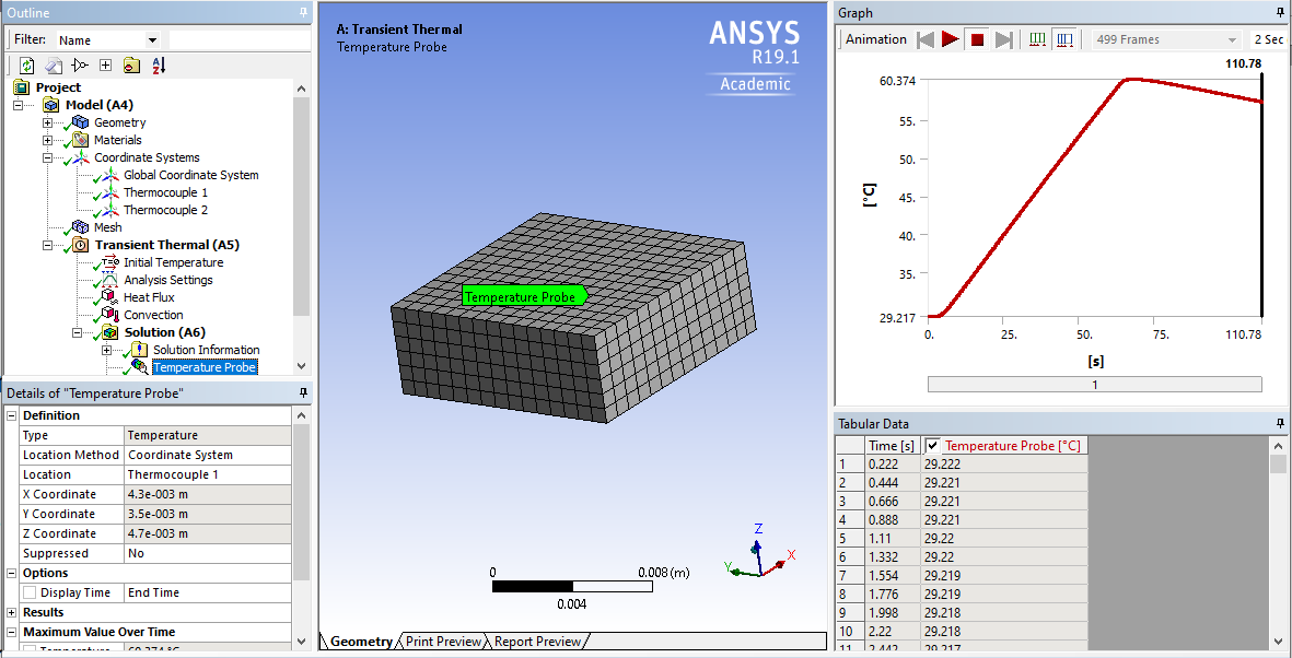

      To get started, I suggest you build a Transient Thermal model using the inputs you have defined and the measured Heat Flux as Tabular input. This graph shows the Temperature at Thermocouple 1.
      Here is the comparison with the Experimental Data to the Ansys Data:
      Changing some parameters like the Heat Transfer Coefficient could get the Ansys data closer to the Experimental data.

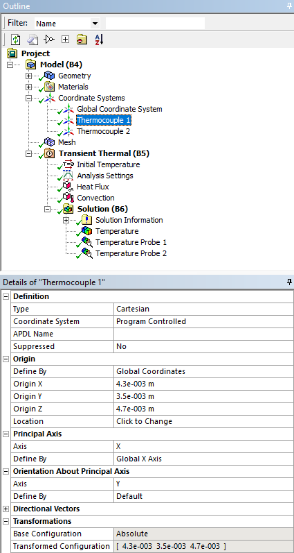

    • rogerio6497
      Good night, I'm trying to enter the coordinates of the two thermocouples, in Transient Thermal - Mechanical [ANSYS Mechanical Enterprise], but I can't type:
      4.3e-003 m
      3.5e-003 m
      4.7e-003 m
      and
      3.5e-003 m
      8.9e-003 m
      4.7e-003 m

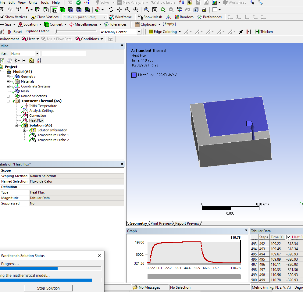

      Also, I cannot enter the heat flow data, attached.
      Sincerely
      rogerio6497

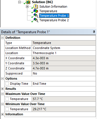

      You can't copy/paste the Heat Flux data until you set the End Time in Analysis Settings to 110.778 seconds.
      Create two Coordinate Systems at the coordinates of the Thermocouples.
      Use the Coordinate Systems to request a Temperature Probe.
      I multiplied the Heat Flux by a constant factor and got this agreement between the Experimental and Simulation Temperature at Thermocouple 1.
