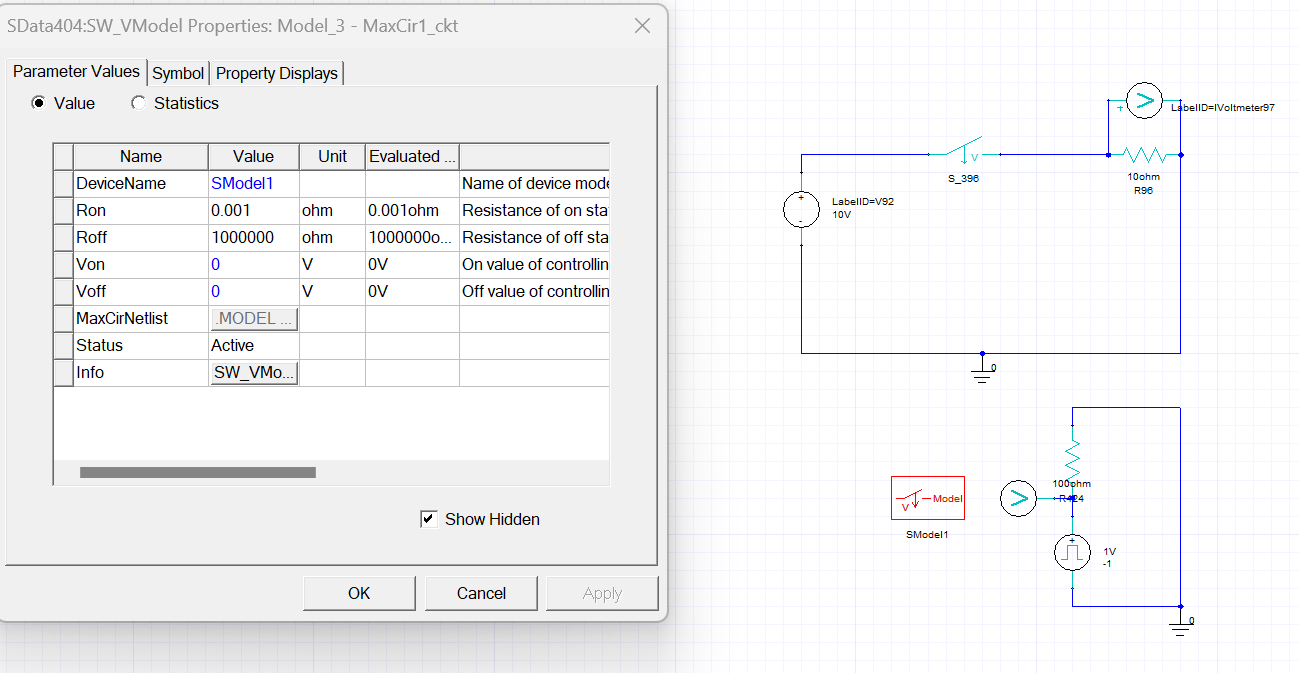

      I want to use switch Component in my circuit. But the switch Component wont work.
      My design is:
      • if the switch is ON, I will get a Voltage of 10V for the 10ohm resistor.
      • -if the switch is OFF, I wil get a Voltage of 100μV for the same resistor.
      But the Switch didnt switch from ON and OFF. It just stayed at the initial condition.

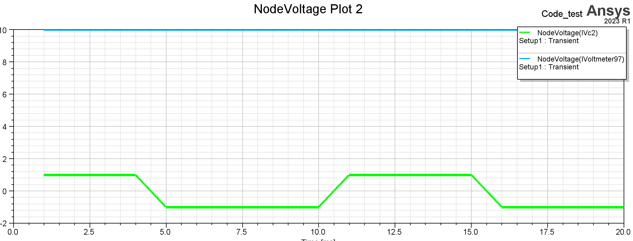

      I attached here the properties of the components and the result(initial condition is ON).

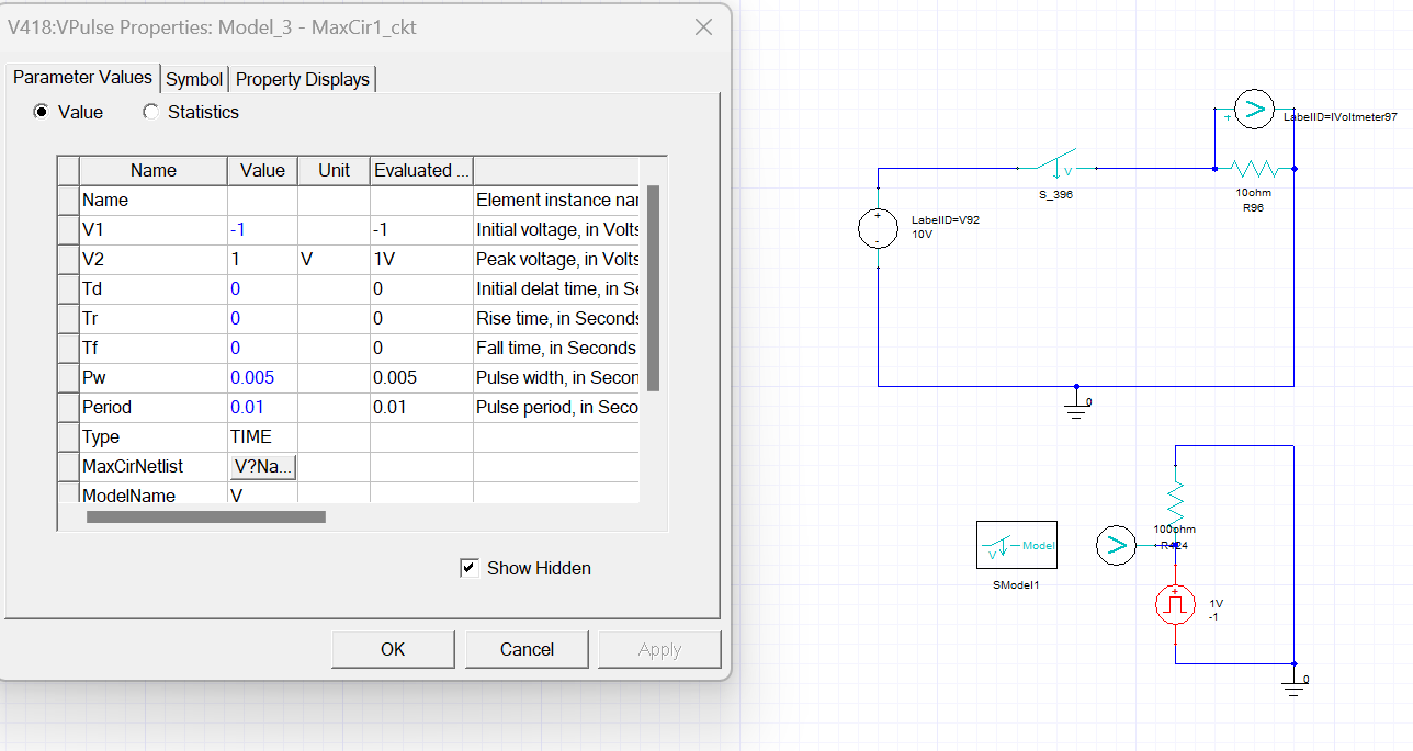

      as you can see, the Puls Voltage souce worked, but the switch didnt work with it.

      Hi
      Could you try export the netlist and reimport it? The pulse does not seem like the same as the settings.

        Hello GL,
        I have already exported the netlist and reimported it, the results remained the same. The Version of Software is 2023R1, and I have Version 2023R2 in the other computer. With 2023R2 there are no such Errors and And the results are shown to be correct.
        Unfortunately the two versions don't seem to be compatible. I copied a model from R1 to R2 and the model would neither save nor run.

      That's weird..Please try saving the model in R1 and open it with R2 instead of copying.

        I tried and it still couldn't be saved. But I can open and save it in a file called "Ansoft". It's the only place that the file can be saved.
