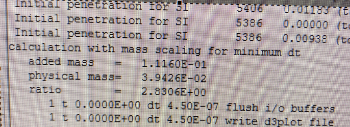

I'm calculating a rubber cylinder with a cord inside, and the result is a rubber tube.
1. I apply 6 MPa pressure to the inner wall of the rubber, and the calculation holds successfully.
2. When I set the pressure to 15 MPa, I get "failure negative volume" messages immediately after starting. And the calculation goes offline.I'm also using Massscale 5e-7.
I've tried many solutions: I've refined the mesh, changed the contacts, and changed the section elements. Nothing helps.
Please help me fix this problem. Thank you.

Clearly the culprit seems to be the loading. Could you do a gradual ramp-up of the load? I would try my luck with *CONTROL_ACCURACY and *CONTROL_BULK_VISCOSITY. What ELFORM is in use? What ELFORMs were tested? Please make sure to keep the mass scaling below 5%, as per the general guidelines.I would also make sure my material parameters are calibrated for a 15 MPA loading.

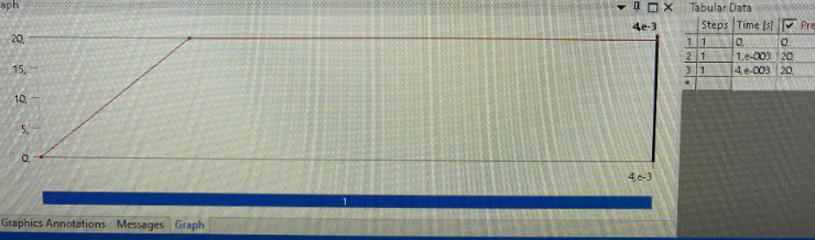

March 4, 2026 at 5:09 pm
javat33489
SubscriberMy load is 0-20 MPa, from 0 seconds to 0.03, then from 0.03 the pressure remains until 0.04 to reduce the kinetic energy
