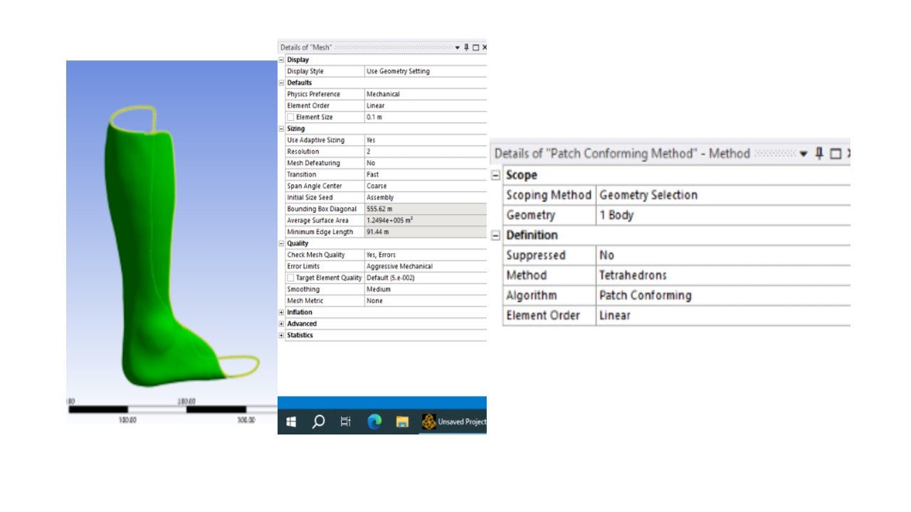

I'm trying to mesh a 3D scan I've imported into Ansys but keep getting the same error e.g "one or more surfaces couldn't be meshed with acceptable quality. Try using a different element size or virtual topolgy".Â
The picture shows the scan and current Mesh and Mesh Method details I am using. I've been playing around with different element sizes but am not getting anywhere.
Does anyone have any advice.

Ansys EmployeeFrom image it looks like a single curved surface. Please split that surface in SpaceClaim into 5-10 surfaces. Then try meshing. Please go through help manual for more details Regards, Keyur How to access Ansys Online Help Document Guidelines on the Student Community Fluids Engineering Courses | Ansys Innovation Courses
