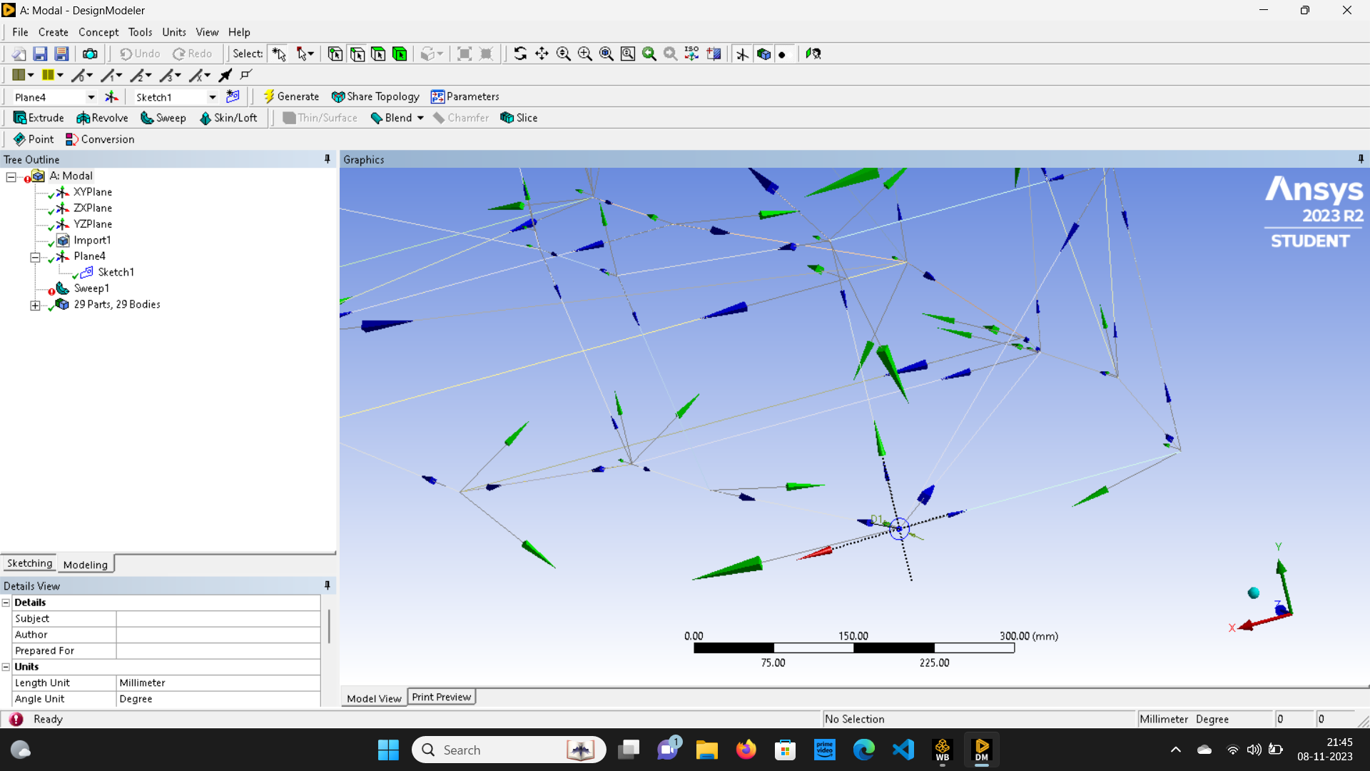

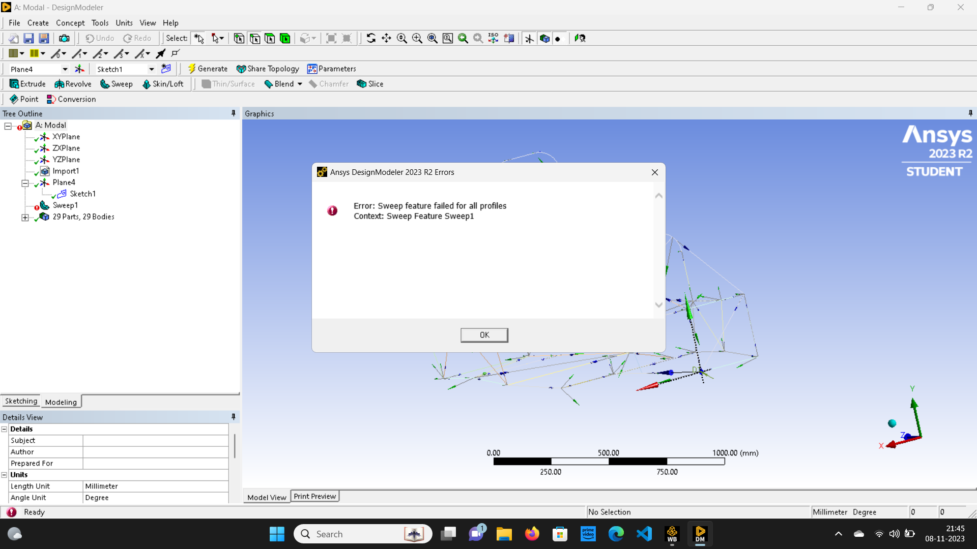

SubscriberI am attempting to generate surface geometry from a set of 1D line bodies representing a Supra roll cage. After creating the profile and selecting the path, I am encountering an issue where the sweep operation fails, and an error message states that the sweep feature was unable to create on all profiles. What could be the potential reasons for this error, and how can I resolve it?
.png)
.png)
November 9, 2023 at 9:04 am
Aniket Chavan
Forum Moderator -
November 9, 2023 at 10:55 am
Nitin Awasarmol
SubscriberThanks for your willingness to help, but I managed to resolve the issue on my own by creating sweeps for smaller sections. It turns out the solution lay in selecting a path with fewer line bodies. I appreciate your support nonetheless!
