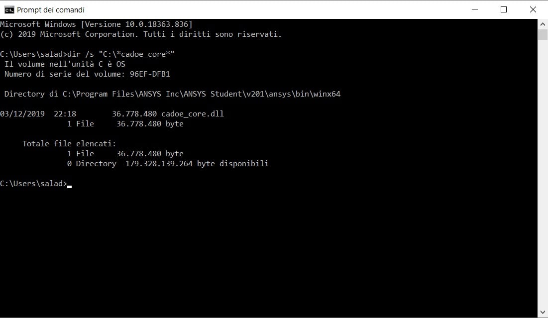

      I installed ANSYS 2020R1 for student and when launching Mechanical APDL i am getting an error "The procedure entry point pow2o3 could not be located in the dynamic link library c:program filesansys incv201ansysbinwinx64cadoe_core.dll".
      I tried to unistall and reinstall program for many times, but I had the same result.
      My computer is Windows 10.
      The output of the following command from CMD Prompt "C:*cadoe_core*" is:
      03/12/2019  22:18        36.778.480 cadoe_core.dll
                     1 File     36.778.480 byte
           Totale file elencati:
                     0 Directory  182.833.889.280 byte disponibili
      I need help for this issue.

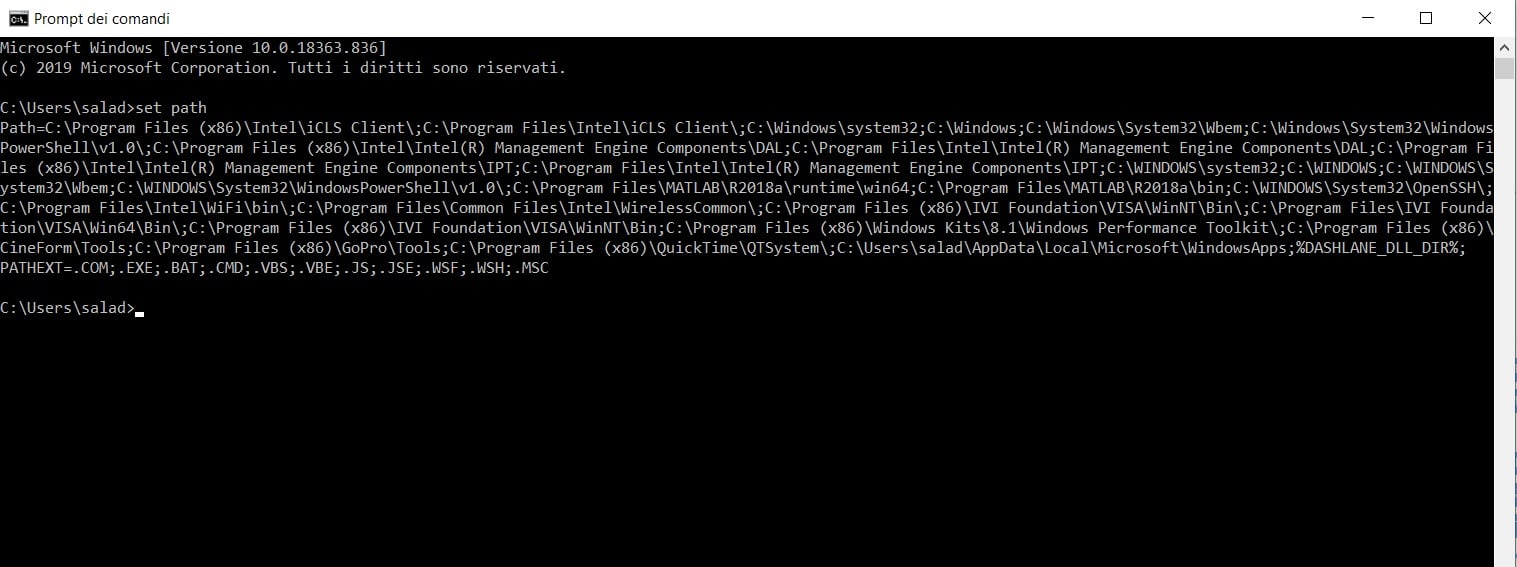

      That output is odd. Could you post the screenshot of the output instead of text ? Please post it in the content and not as an attachment.
      Also, please post the output of
      set
      command from CMD prompt.

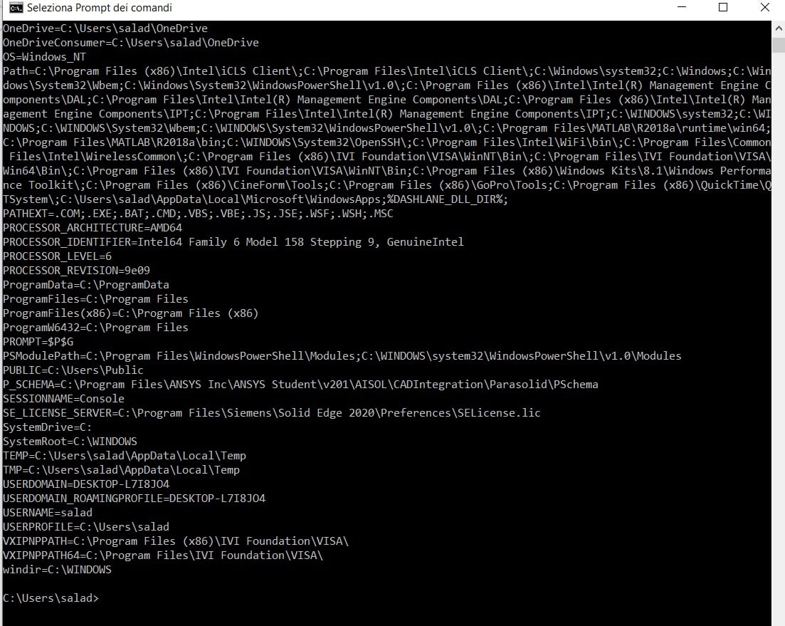

      It seems you miss some libraries that the dll is looking for.
      Can you try reinstall the software again ? Make sure you 'run as administrator' and if possible, turn off security software while installing it. Additionally, make sure you completely remove the ANSYS Inc folder before you re-install.
      Please also post the entire output of 'set' command , not just 'path'

      This is the output of 'set' command

      and if you run this command again
      dir /s "%awp_root201%*cadoe_core*"
      Do you still see just 1 file in the output ? You are supposed to have cadoe_core.dll and cadoe_core.lib but the .lib was missing from your previous installation for some reason.
      If you still miss the .lib this time, may be it's best you re-download the installation package. And it may be because of the default language of your systems is not English. If you can change it to default to English before installation, that would be great. Otherwise, another way is to find a machine with already have Windows as default language, install ANSYS on there, and just manually copy installed directory over to replace those on this machine.
