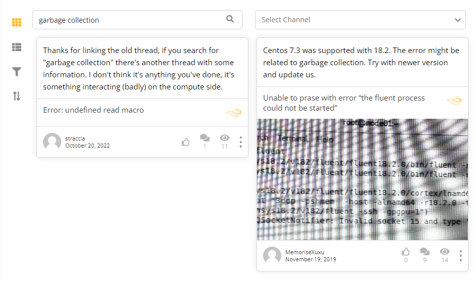

      Thanks for linking the old thread, if you search for "garbage collection" there's another thread with some information. I don't think it's anything you've done, it's something interacting (badly) on the compute side.
    • straccia
      Hi Rob, thanks for your response. When I search for garbage collection, I only see these results (my question and another question that does not say anything relevant about garbage collection: /forum/forums/topic/unable-to-prase-with-error-the-fluent-process-could-not-be-started/). Am I missing something?
    • straccia
      It appears that removing the monitors from the .cas file fixed the issue, as the garbage collection article suggests: /forum/forums/topic/unable-to-prase-with-error-the-fluent-process-could-not-be-started/
