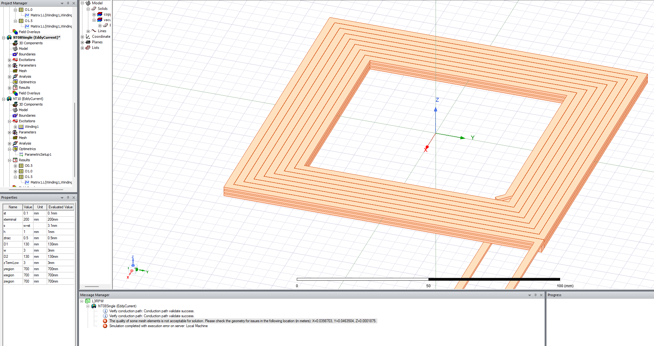

      I am running a series of parametric simulations of a planar winding, and for some specific parameter values I get the following error:
      The quality of some mesh elements is not acceptable for solution. Please check the geometry for issues in the following location (in meters): X=0.0398703, Y=0.0463504, Z=0.0001875.
      Any suggestions on how to fix this? Would it help to make the mesh more fine?

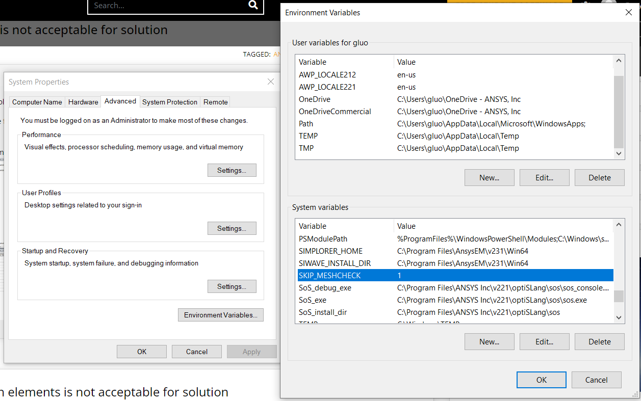

      You can set the SKIP_MESHCHECK to 1 under Environment variables to eliminate the error.
      System properties>Environment variables

      Hi @Navya,
      could you please let me know where I could find the system properties?
      Best regards
