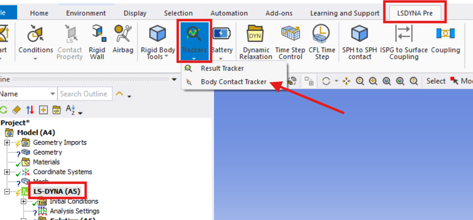

SubscriberI am trying to extract contact force using contact force tracker (added by right clicking the 'Solution Information') scoped to a rigid body (tool) interacting with a flexible body (workpiece), when trying to simulate an orthogonal cutting process in ANSYS 2021R1 LS-DYNA. I only used 'body interaction' as a connection between these two bodies, with a frictional coffecient entered as 0.3, with no other contacts built betweeen these bodies (like bonded, etc). However, when I try to evaluate the results after solution has finished, the contact force tracker doesn't work, and generates me this error as I am sharing in the picture. I don't know how to add the body contact tracker, because I don't see any option to add it from anywhere (like it doesn't show up in the 'Solution Information'). Can you tell me how should I address this issue?

Please follow the below steps:
- Open the LS-DYNA Pre toolbar before solving your model.
- Insert a Body Contact Tracker and scope it to the rigid body (tool) or any relevant body for which you want to extract contact force.
- Ensure the tracker is set up prior to running the solution. Post-processing contact forces is only possible if the tracker is present before solving.
- After the solution, use the Body Contact Tracker to evaluate and plot the contact force results.

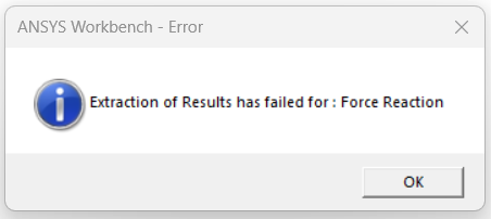

I then tried using the reaction force probe to evaluate the reaction force on the rigid body. However, this is the error I encountered:
 I had to drag and drop the boundary condition scoped to the rigid body, onto the Solution Information because when I tried to directly insert a force reaction tracker, the 'Boundary Condition' box was yellow, which I believe signifies that the solver hasn't identified any valid boundary conditions whose force reactions can be calculated. I used only one Displacement BC on the rigid body, with z = free (velocity direction), x = y = 0. Can you please help me spotting where exactly I am making a mistake?  -

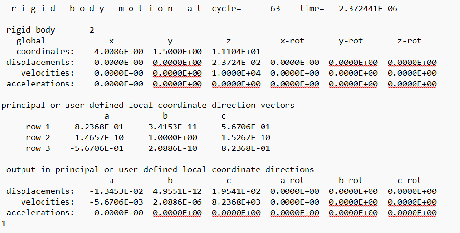

The recommended and most accurate approach is to extract forces using a Rigid Body History Output (or *DATABASE_RCFORC at the keyword level), which provides the total resultant forces acting on the tool, including all physical contributions. You should also define a local coordinate system aligned with the cutting and feed directions to correctly resolve Fc and Ft components from the resultant force vector. I believe, the discrepancy you are observing can be resolved by switching to rigid body force outputs with proper coordinate system alignment.
Also, in situations like this, the experimental forces (Fc and Ft) include not only contact contributions but also inertia, material deformation resistance, and other dynamic effects inherent to explicit analysis; therefore, relying solely on contact forces may underestimate the actual values. How big of a difference do you see now?Best,

I tried what you suggested. Since I am operating LS-DYNA through ANSYS WB interface, I went to the 'Time History Output Controls' under the Analysis Settings, and I chose the Rigid Body Data option from the drop-down menu. I guess this is what you meant by the 'Rigid Body History Output', isn't it? However, after locating the Solver Files Directory and opening the created RBDDOUT file, this is what I found (I am just sharing a portion of the file for explanatory purposes):
I couldn't see any resutant forces, but just displacements, velocities, and accelerations. So I am a bit puzzled. Secondly, the SPCFORC file, to my shock, empty. Could you please elaborate what am I missing esentially? The setup is simply a rectangular block (workpiece) undergoing orthogonal cutting by a rigid tool, so nothing fancy. Thank you.
