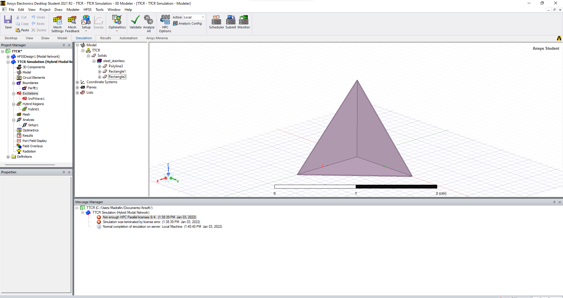

SubscriberHello, can someone tell me what does this mean? I'm trying to run SBR+ simulation in ANSYS HFSS and receiving this error when simulating. Is there any method to solve this? I'm using Ansys Electronics Desktop Student 2021 R2 and very new using this software. Hope someone can help me solving this issue.

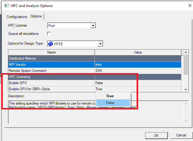

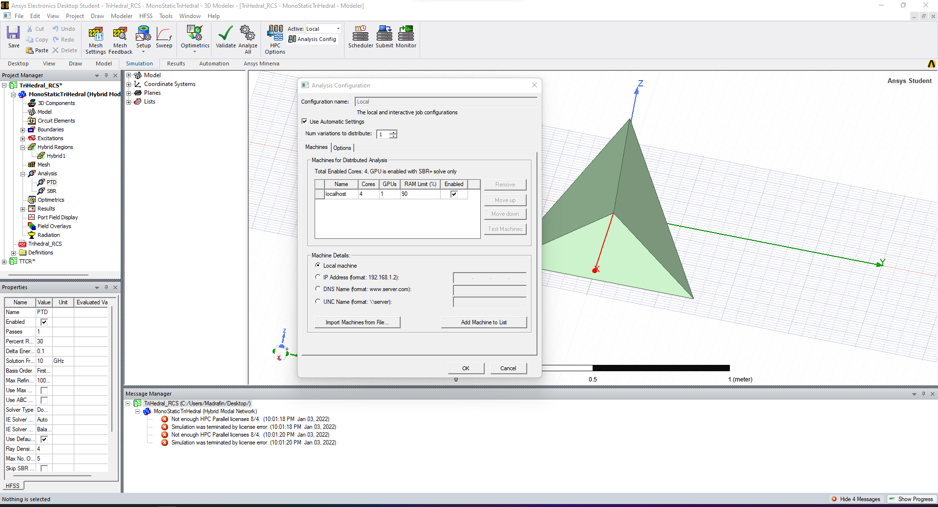

Forum ModeratorPlease change your HPC and Analysis Options to only use 4 Cores rather than 8 cores.
