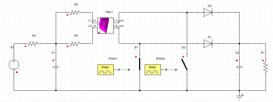

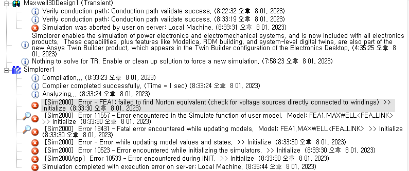

      I am trying to use simplorer and add the 3D ansys maxwell transient component (inductors). But it have this error, please help you solve this error.
      Thank you in advance!

             Could you right click FEA1 and go to "Edit Model" to check if you add Maxwell design in the componet?
             Could you check one example in the folder of "C:\Program Files\AnsysEM\v232\Win64\Examples\Twin Builder\Components\Interfaces\Maxwell\TR-TR\2D\" ?
