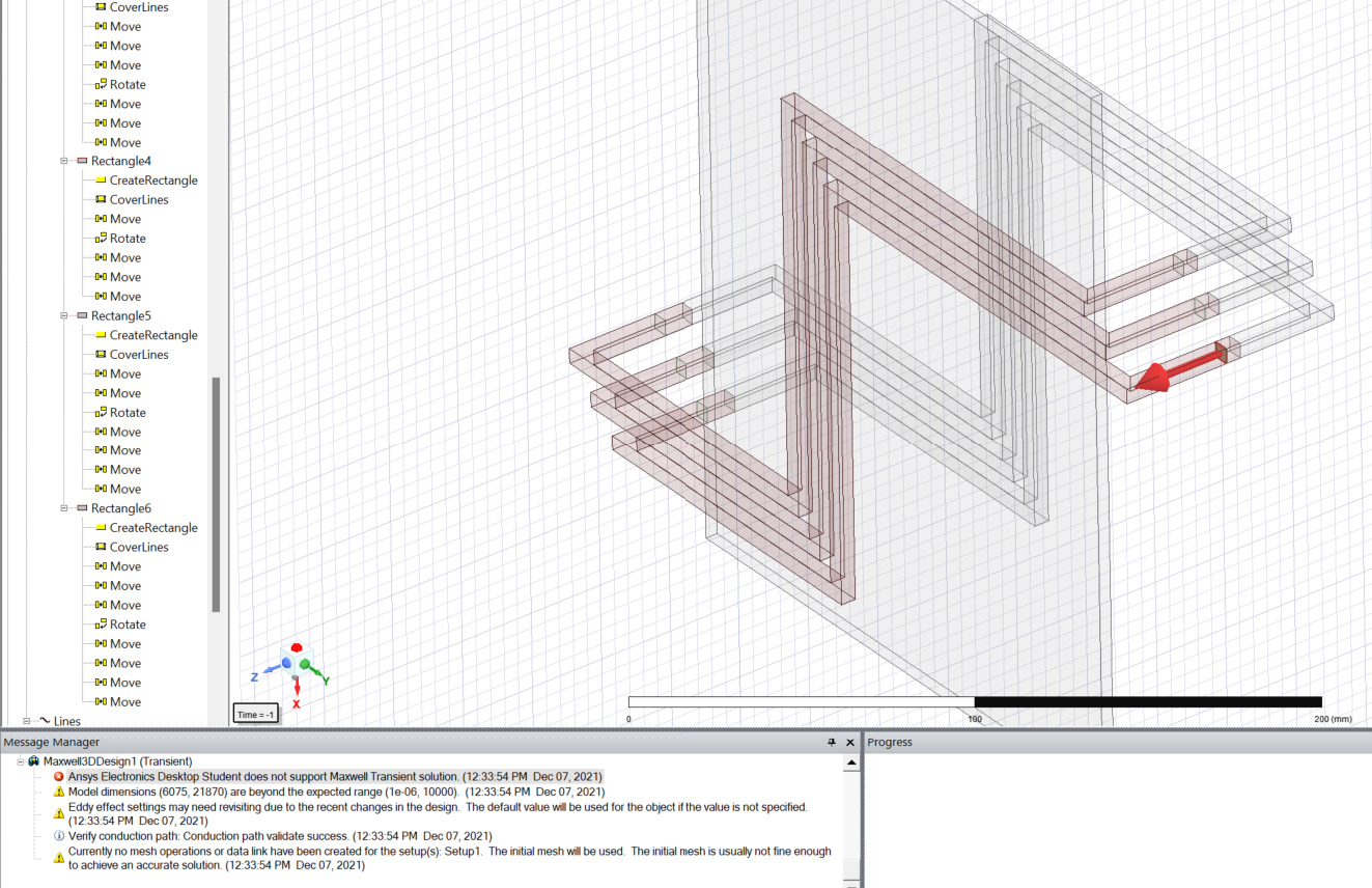

SubscriberHi everyone,
I'm new to Ansys and am experimenting with Maxwell. While trying to simulate a few single conductor coils in Magnetic Transient mode, I got the error code "Ansys Electronics Desktop Student does not support Maxwell Transient solution". Just want to confirm - does this mean transient solutions are for paid licences only?
December 7, 2021 at 6:25 amNavya Chode
Forum ModeratorHi @Bayerisch Yes, transient analysis is not supported at this time in the student version.
