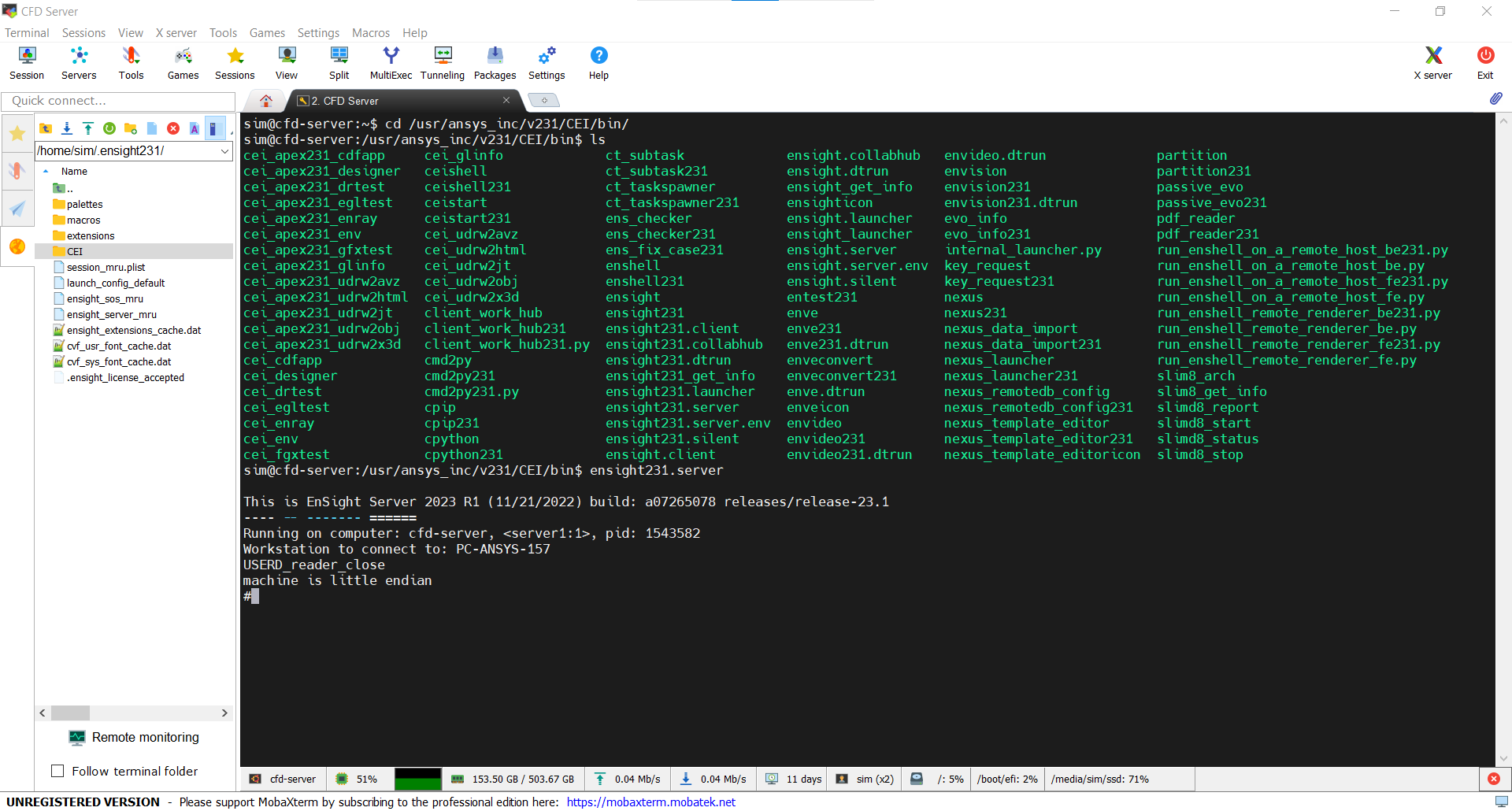

After reading the costumer portal posts and the manual I am still unable to run the Ensight remotely. I follow the steps below:
1- Enisght runs indpendently on both client and remote host machines.2- I have included the ensight path in bashrc of Ubuntu.
3- running the command ensight -l I get the the following message:
Available versions:
  231 (latest)
By default, 'ensight' will use the latest version available. Select a specific version
to run with the '--useversion ###' command-line argument.
4- I have ensured the the passwordless ssh is established between windows and ubunu. I the ensight launcher i enter the following:
plink -i "path to private key"5- I start the remote server by running ensight231.server -cm to listen to the client connection
6- in the ensight launcher in the client side i choose client conncect to the server
There is no firwall in windows nor in ubuntu.

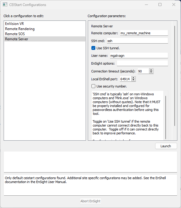

Have you tried using ceistart instead of manually starting the connection? It basically is a wrapper around the commands you're trying to use.
Launch it with "ceistart" from the Ansys_installation\vXXX\CEI\bin directory. Then select the Remote Server option.
You'll need to enter hostname for the remote machine and your username. As long as the remote machine is configured correctly, then this should start EnSight with client locally, and server remote.
Hope this helps.

Ansys EmployeeHi,
Apologies for the late reply.
First, you should not need to start the server manually on the Linux, ceistart will take care of that.
Second, can you try to toggle on the SSH tunneling option and see if that changes the situation?

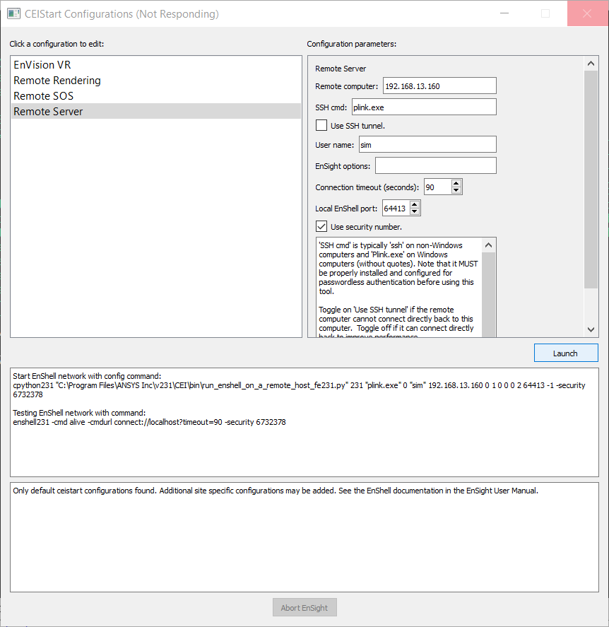

SubscriberNothing happens in sever side. no process starts.Â
from client side CEIstart keeps unresponsive when i press launch

Ansys EmployeeHi,
If nothing happens on the server side, there are 2 possibilities:
- the connection isn't happening. It could be an issue with passwordless connection, machine/user name, firewalls or needing to reverse the SSH tunnel. There's no easy way for me to debug this without access to the machine
- the connection is made, but the executables on the linux machine aren't found. If you ssh into the machine, you should be able to start 'ensight' (which might now work as you have no graphical server, but that's not the point) without having to set any executable path. If this isn't the case, then this needs to be fixed.
The alternative is to manually do the connection. On the windows machine, type:
ensight_client.bat -cm
This will bring up the EnSight interface, waiting for the server connection. Now on a second shell, ssh into the linux machine, and on that type:ensight_server -c
Assuming there is nothing stopping the connection and you have the exact same version installed on both machines, this should bring up on Windows EnSight, with its backend running on the linux machine.Â
