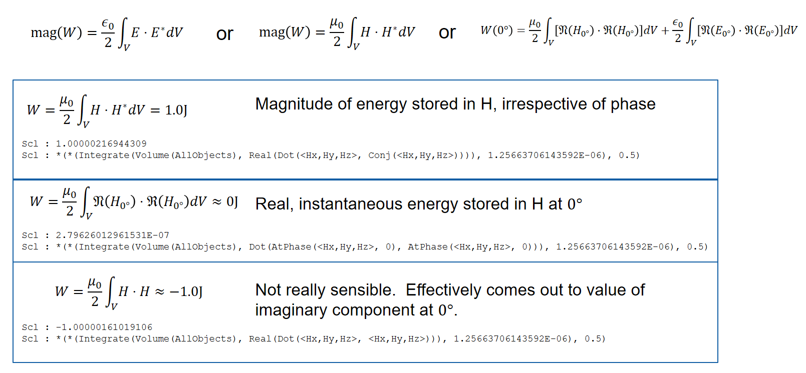

SubscriberI set the energy in eigenmode simulation (Fields=>Edit Sources) to be 1J. Then I integrate the simulation domain on 1/2(eps|E|^2+mu|H|^2). And I got exactly 2J. I have made sure I use the correct E and H. Is this expected? Why it is 2X larger than the assumed energy? Thanks!

Subscriber@hywong2 Sounds like half your energy is stored in E and half in H.I would assume the discrepancy arises because HFSS is normalizing your eigenmodes to energy stored in the E-fields only.Thus, quantity (eps_rel*eps_0/2 * int_volume ( E dot E*) dV ) should yield 1.0J.You'll want to account for this if you use a different convention.
September 14, 2021 at 7:37 pmjdmac
SubscriberActually, here's a clearer answer: This is the difference between energy stored over a complete wave cycle vs. instantaneous energy. If you're going to do 1/2(eps|E|^2 + mu|H|^2), then you need to take the Real component of each E and H term before your dot product. You can use the AtPhase function (from the Complex drop down menu) to specify which phase you're evaluating fields at.
Scl : Integrate(Volume(AllObjects), Dot(AtPhase(, 90), AtPhase( , 90)))
Otherwise, if you just do E . E* + H . H*, then you're double booking the energy.

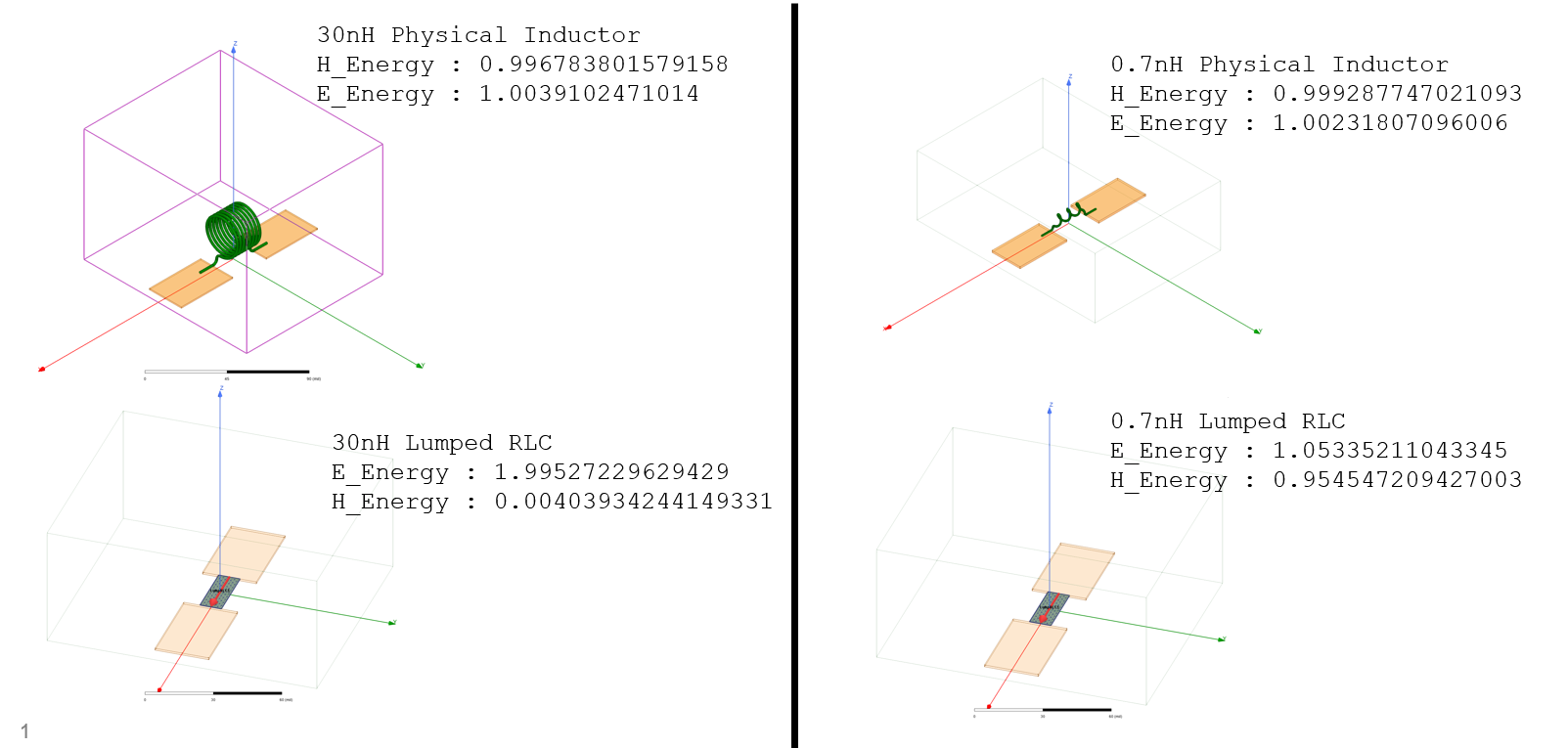

September 16, 2021 at 6:39 pmhiuyung.wong
SubscriberThank you very much! I tried what you said but the result is strange. I got about 0.002J when integrate H (instead of 1J) and 1.998J when integrate E (instead of 1J). But I realized that this is because I have a lumped RLC boundary condition with ~10nH inductor. If I make it very small (e.g. 10fH), then I get 1J in both integration (same as yours). Any idea why adding a lumped inductor will cause this issue? Thanks!
September 16, 2021 at 8:43 pmjdmac
SubscriberFascinating. I don't know the answer to that one. I assume your H field is not 0. I wonder if the Lumped RLC causes H to cancel out when you integrate over the whole domain? I think the lumped RLCs work by applying a current, so I guess that's possible. It sounds like energy gets redirected into E, thus satisfying conservation of energy. Interesting. I'm not sure if that's physical or a quirk of the lumped RLC element. I suspect it's the latter, since a physical inductor works by storing energy in magnetic fields. If I were you, I'd plot an animation over time of J on that lumped RLC. And also look at a 3D plot of H. Maybe someone else will know why this is.
September 17, 2021 at 1:04 amhiuyung.wong
SubscriberIt is right that the energy goes to the inductor. The only thing puzzling me is that energy in E is integrated to be about 2J and energy integrated in H + energy in the inductor is also about 2J. If I set the eigenmode energy to 0.5J, they both scale accordingly (reduced by half). If the extra energy is due to the current applied as you said, looks like it is using the same setting in the eigenmode energy. Just to share what I observe. Thanks!
September 21, 2021 at 2:21 pmjdmac
SubscriberYeah, I'm not sure what's going on here, but it's definitely non-physical.
Plainly, when you compare LumpedRLC inductors with physical inductors, for the physical version, energy stays balanced between E and H, whereas for the LumpedRLC inductor version, energy gets transferred entirely to E as the inductance value grows. There is some quirk of the currents applied to make the Lumped RLC boundary condition happen that radically alters where energy is stored. The thing you have discovered makes me distrust Lumped RLCs for eigenmode problems.
