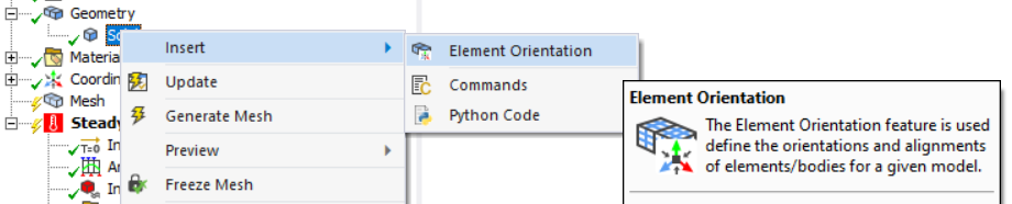

SubscriberI'm trying to analyze a cylindrical part on which I need to define orthotropic material properties for which I need to orient the axes of each element as per a cylindrical coordinate system. However I can't see a suitable option to do so in Workbench or think of an alternate methodology. Can someone share their insight in order to overcome this issue?
February 14, 2022 at 6:27 pmFebruary 14, 2022 at 7:20 pmWolfgangNeil
SubscriberThere's no option to implement a cylindrical CS using the option in the picture you have shared.
For a cylindrical geometry, it'll result in inaccuracy if we use a Cartesian CS for the element orientation as one direction needs to follow the curvature of the element.

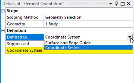

You can create a cylindrical coordinate system by right click on Coordinate systems>insert>coordinate system.
After creating one, you can create element orientation and change the "Defined by" to coordinate system and select your cylindrical coordinate system.

But I want to know whether this option has resulted in defining the material properties w.r.t the chosen global CS (as I can't visualize the element alignment grid) or implemented locally to each element similar to when I choose the "Defined By" as "Surface and Edge Guide".
February 16, 2022 at 9:38 pmpeteroznewman
SubscriberOnce the solution is done, you can right click on Solution and insert Coordinate Systems/Elemental Triads. Once you Evaluate Results for this item, you can see the Elemental Coordinate System for the elements of the selected geometry.
