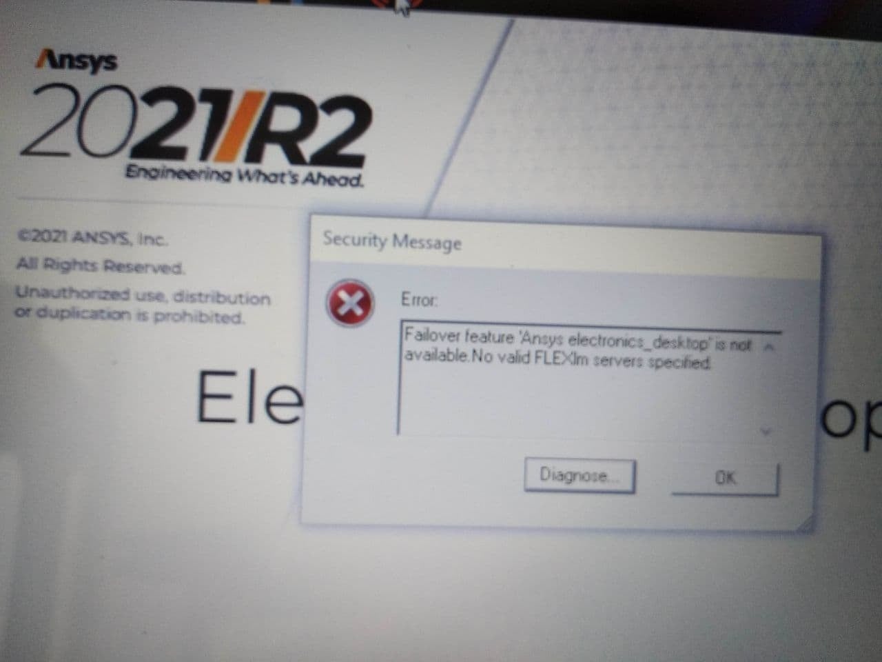

I have installed ANSYS ELECTRONICS DESKTOP STUDENT Version. I am getting below error while running the tool.
Please help.

Forum ModeratorThere is no need to create the ansyslmd.ini file for the Student version. Please ensure there is no ansyslmd.ini file in C:\Program Files\AnsysEM\Shared Files\Licensing. Please also make sure you do not have the environment variable ANSYSLMD_LICENSE_FILE set on your system. The license is built into the 2021R2 Electronics Student package and doesn't require any additional settings.
Please note Ansys 2021R2 is available for customers on the Customer Portal and has been since July.
