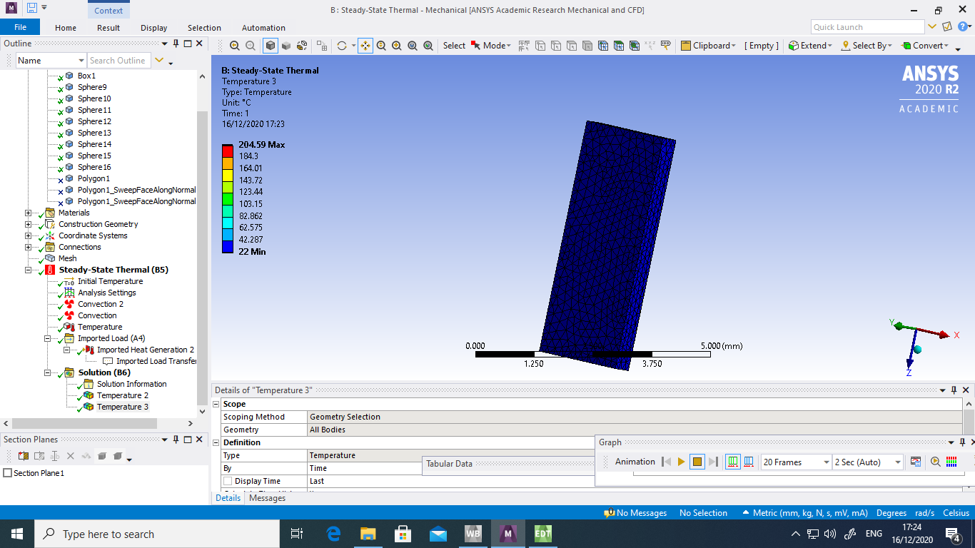

      From the figure you could see both the normal view and sectional view. I have a Al plate and inside this plate I have MnB spheres. I would like to transfer the heat from the spheres to the plate. I have tried various boundary conditions, but couldn't find the correct one in my case. As there are two different materials, how could we make a thermal contact so that we could see the temperature gradients?

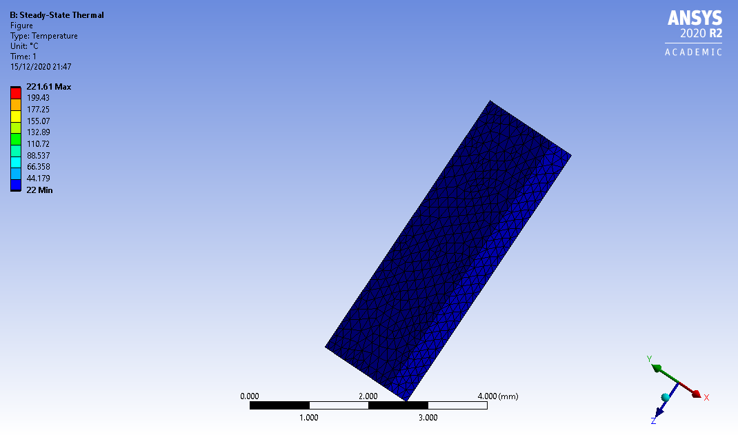

      The simulation results which you see in the figures are obtained by coupling with maxwell. The ohmic losses from the maxwell serves as an input to the setup of steady-state thermal. Now when I import the load for the plate and the spheres, I don't get the exact losses as observed in maxwell.
      Regarding the boundary conditions, in maxwell the simulation didn't run as it was intersecting the inside of the plate. For this reason, the spheres are located inside the plate without touching any faces inside. Now when it comes to steady-state thermal, as these spheres and plate don't have any relation they were made as bonded contact. Convection was used for the outside faces of the plate. The problem is after trying all boundary conditions like convection, coupling, ... I couldn't actually find a suitable way by which I could allow the transfer of heat from the spheres to the plate.

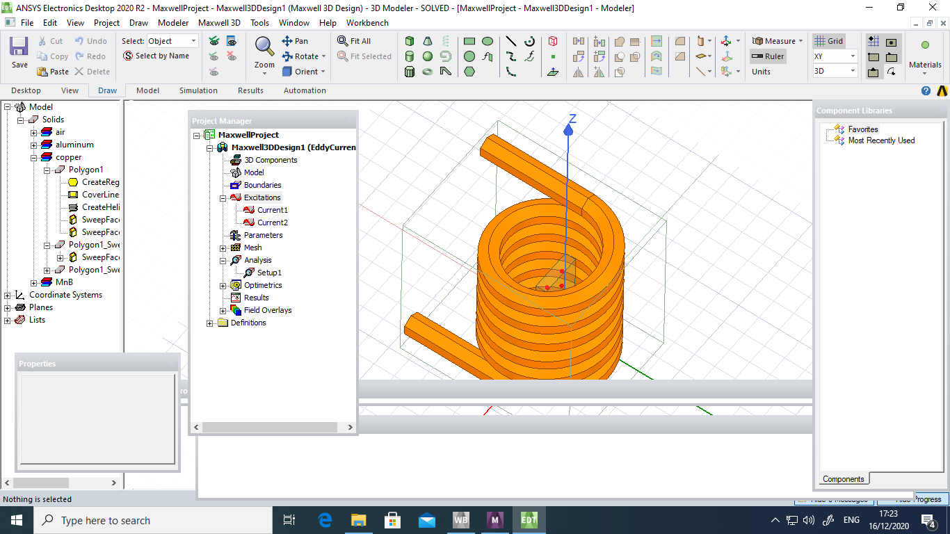

      The first figure shows the model in Maxwell with an coil for induction heating of the plate with spheres inside. The second figure shows the steady-state thermal where the results from maxwell are coupled to import load. Essentially, due to induction heating of the plate, both the plate and spheres undergo different ohmic losses and as a result I would like to plot the temperature of the entire model but with a heat transfer from the spheres to the plate.

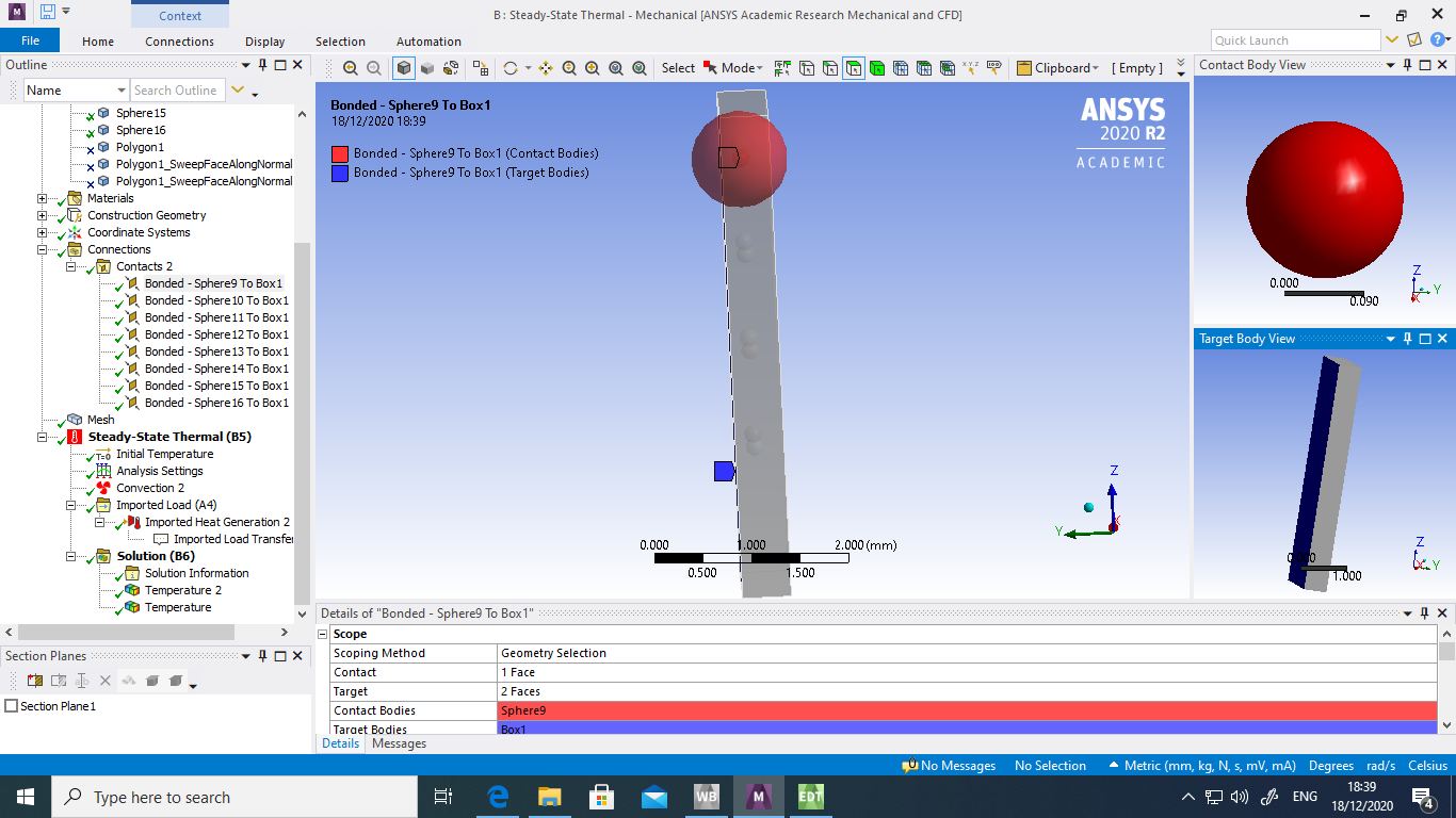

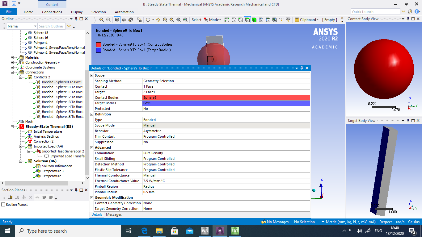

      rkumbhar thank you for your reply. Please find the screenshots of the settings used for the contact. I have used the pinball approach to create a thermal contact between the spheres and the faces of the plate. Also, do you know why the ohmic losses are so low for spheres ( in my case the spheres are 0.09mm and when import load from maxwell, the ohmic losses are low) But when I simulate the spheres alone without the plate, I get high ohmic losses)
    • Rahul Kumbhar
      Hi Array The contact doesn't looks good. You have the contact between sphere surface to plate surface. Instead the sphere should be substracted from the plate to create cavity. Then there should be contact defined between sphere surface and cavity surface of the plate.
      You can use large pinball radius to define the contact and all other program controlled options. Also are you selecting all the bodies in imported heat generation object? The overlapping constraints such as convection, imported heat and contact all on the same face can this type of issue. I would suggest first to modify the geometry by substracting the spheres.

      You have contact between the spheres and faces of the plate. On the same faces of the plate, there is convection boundary condition. So you might not bale to see the proper heat transfer. My suggestion still would be to create cavity in plates around the spheres and have the bonded contact in those places.
