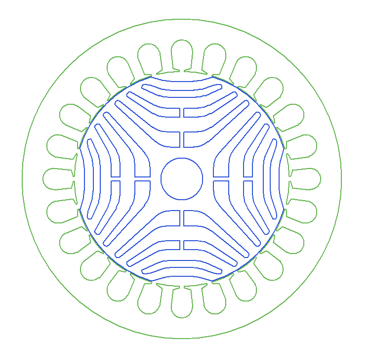

      How to draw synchronous reluctance motor rotor in ansys maxwell 2D
    • Navya Chode
      Hi sampathkumar,
      1. You can use the drawing tools and boolean operations under the draw tab to create the shape you want.
      2. There is an inbuilt RMXprt example in the below path. You can use it to create the Maxwell design.
        File>open examples> RMxprt\grm\SynRRotor.aedt
      3. Another best way is to create the required structure in any CAD tool and import the .dxf file into Maxwell.  If you have a 3D sat file, you can import it in Maxwell 3D and create 2D out of it.
