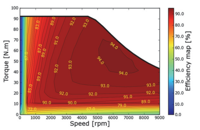

I need to display the contour lines on the efficiency maps with the efficiency values Using Machine toolkit, to produce a map similar to the one below. Any suggestions how to do it?

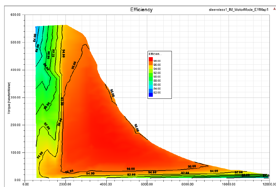

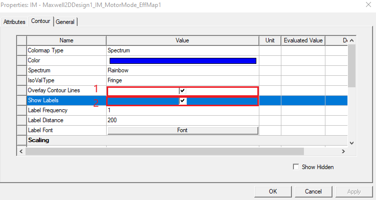

August 20, 2021 at 1:48 pmAugust 20, 2021 at 6:53 pmhkanakri
SubscriberHello Deli,
This is great, and solved the issue. Thank you so much!
-Haitham
