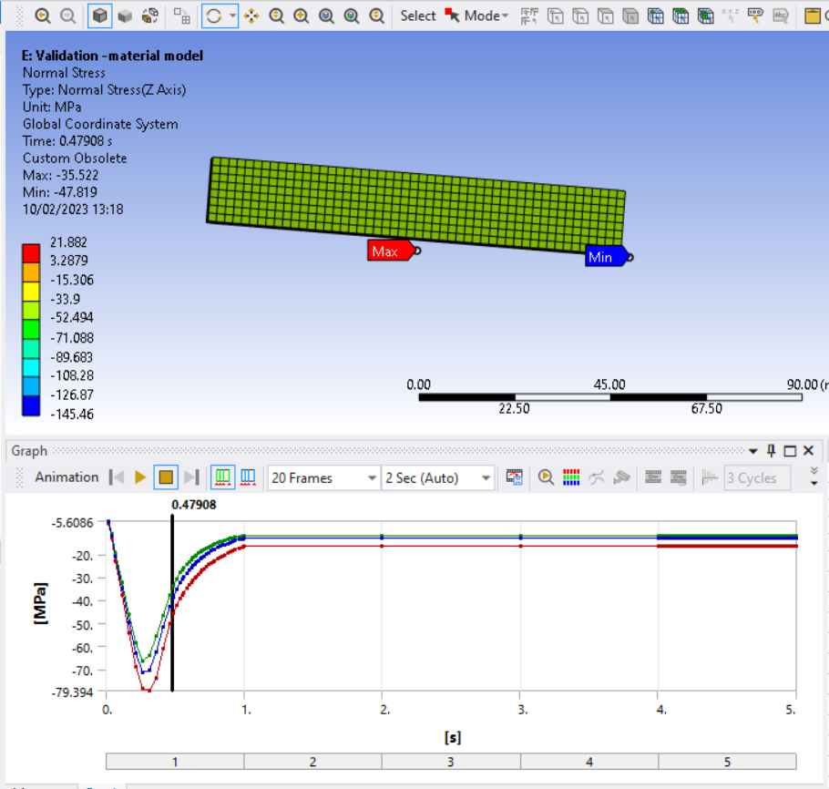

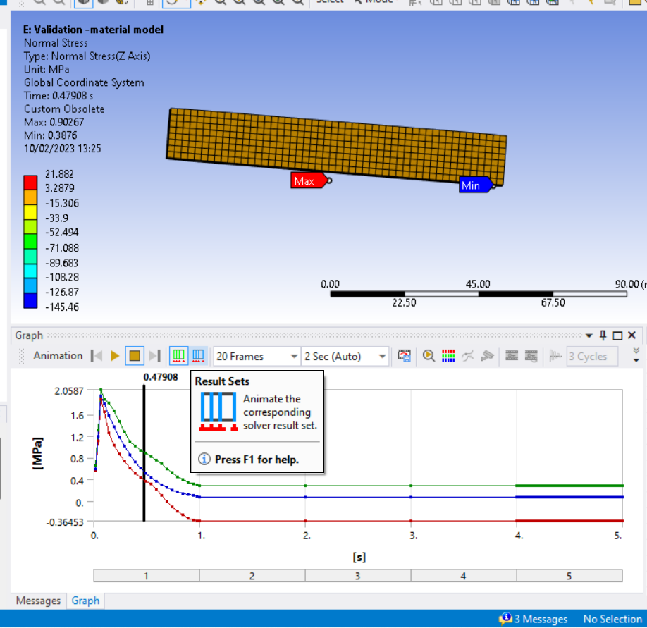

      -Trying to validate the defined parameters, I modelled a generic beam and subjected it to uniaxial and flexural deflection schemes.
      The uniaxial loading conditions gave the expected results, with both compressive and tensile stress values peaking at the defined strength parameters before softening occurred. I have attached images below:
      Fig.1 Peak compression
      Fig.2 Peak tension

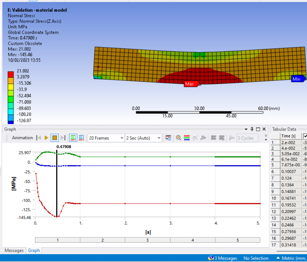

      -In contrast, flexural loading conditions give results for peak normal stress which significantly exceed defined parameters, even after varying the applied displacement on the beam.
      Fig .3 Peak compressive and tensile stresses for the flexural loading condition.
      It is my understanding that the normal stress in the z-direction is composed of Tensile and compressive stresses beneath and above the neutral axis respectively. I would appreciate feedback on possible errors in my assumptions or potential reasons for the disparities in results.
