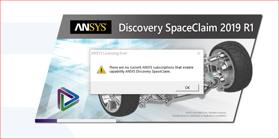

      Hi we have a customer who is having trouble activating. See below error message.
      We have tried the connection test and are getting a 0% loss.

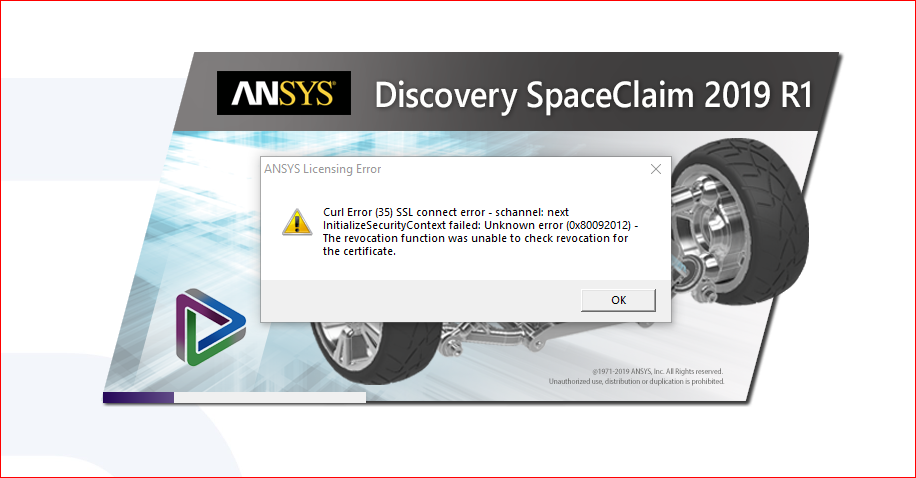

      It looks like it's pointing to a curl error so we have been through the resolution steps in FNE Activation Failed. Peer certificate cannot be authenticated with given CA certificates with no success
      Downloaded and installed all the correct certification.

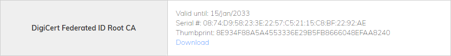

      I see from your email that you have followed this FNE Activation Failed. Peer certificate cannot be authenticated with given CA certificates . Could you please ensure that the customer has the DigiCert certificate listed as mentioned in the last few points of that page?
      If that doesn’t work. Could you please make sure you allow the access to certificate check
      URL :  ocsp.digicert.com<http://ocsp.digicert.com/
      Also, could you please share with us what is the operating system the customer is working on?
    • tim.dukes
      Hi Subashni

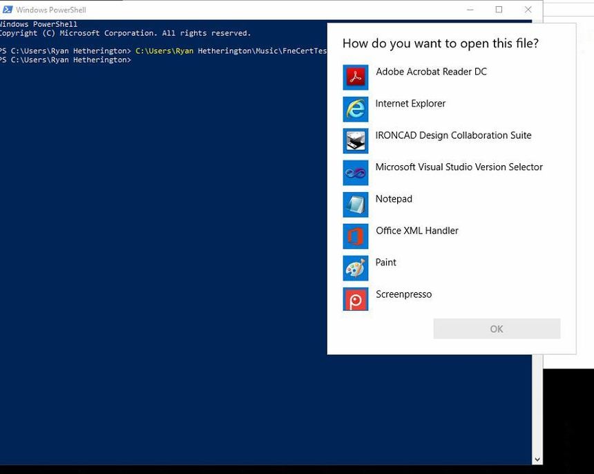

      I've logged on with the customer and tried to run the powershell command as in the image below.
      This then brings up the below.  When clicking open with Notepad we get the results attached in the .txt file.
      This then brings up the below.  When clicking open with Notepad we get the results attached in the txt document attached. This has been run as admin also.
      Also been to https://www.digicert.com/digicert-root-certificates.htm#roots and have downloaded, ran and installed the certificate from there.
      When just running the FneCertTest.ps1 we get the below.
      # DigiCert:
      Get-ChildItem -Path Cert:LocalMachineRoot | Where-Object {$_.Thumbprint -eq "A8985D3A65E5E5C4B2D7D66D40C6DD2FB19C5436"}
      Note: Customer is using Windows 10 OS
