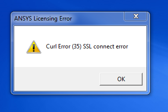

SubscriberHave just seen this which is what customer is seeing when checking the connection so will try these steps.

Based on the images in the email received from the customer, my initial guess is that they are running an older version of Discovery that does not support an enterprise floating license. I have advised the user to download and install Discovery 19.2.

SubscriberHi, could you tell me, what is the solution of this problem, please?
Our customer has the same problem. He has subscription and Discovery 19.2.
The error is: Curl Error (35) SSL connect error
Ping to  ansys-fno.flexnetoperations.com is OK.
Thank you, Lukas

SubscriberHi Lukas
I think our customer did a manual activation in this instance. We have had other customers with Curl error and this was due to proxy server issues so following this may be worth a try. Discovery – Patch for addressing proxy server issues
