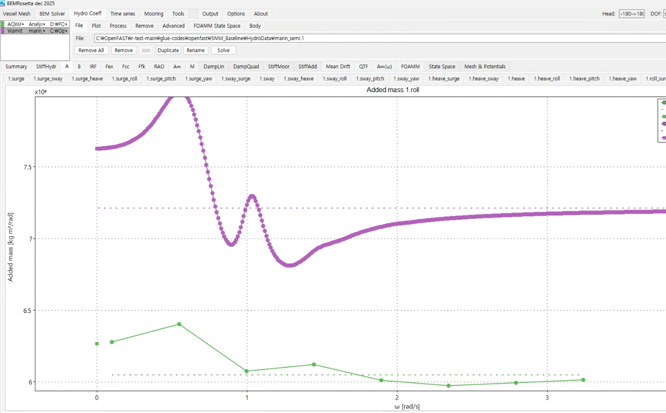

      Due to my insufficient back ground knowledge i've got to some questions about "Thin" and "Line Body".
      I understood that "Line Body" as a Morison's element is not included in calculation of potential theory, for example added mass or radiation damping coefficient. (Am I right?)
      So i designed lower pontoon and bracing of NREL reference wind turbine as "Line Body" instead of "Thin" because they have relatively small diameter with respect to length itself.
      But i found out serious mismatching about heave added mass down below. (Case 01)
      So i desinged lower pontoon as "Thin" (Case 02) and bracing (Case 03) too, so that i could get similar behavior with reference(caculated by WAMIT).
      And I also found out that pitch radiation damping does not align with reference.
      More over, result of "Froude-Krylov Force" and "Diffraction Force" in pitch, yaw direction of Case 03 has serious discrepancy like down below:
      Thus I can't trust heave added mass result for Case 03.
      So my question is:
      Q1. Why does designing lower pontoon as "Thin" make substantial difference in "heave added mass"?
      Q2. How can i deal with "pitch radiation damping" coefficient.
      Q3. What is the actual difference between "Line Body" and "Thin"
      Q4. Can I use "Case 03" design to match heave added mass?

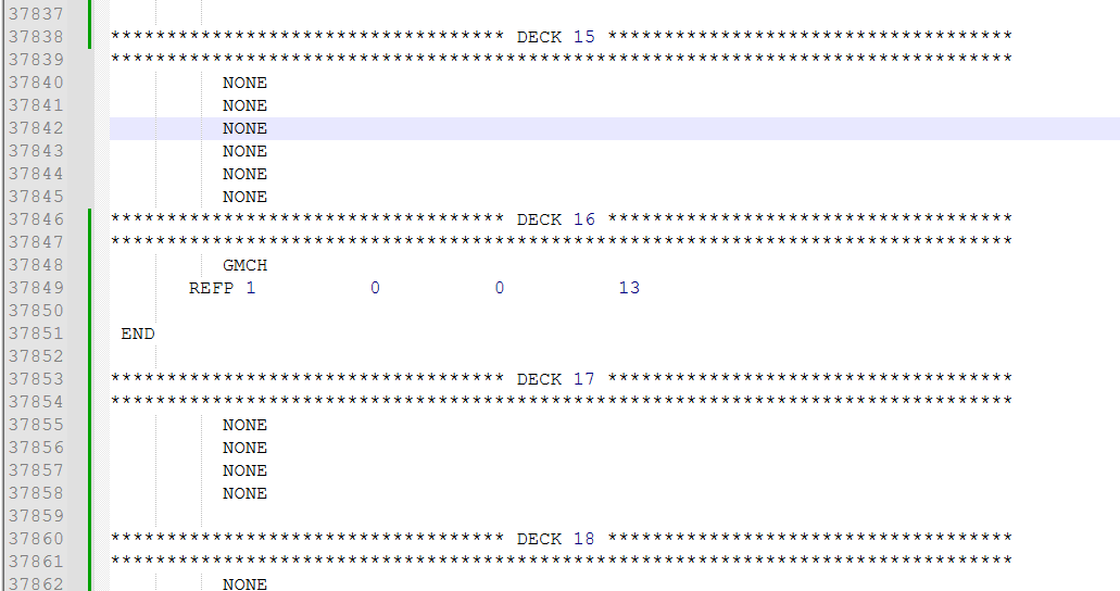

      I recently found that the problem was about the reference axis.
      NREL sets origine point at "Mean Sea Level" while AQWA sets at "Center of Gravity".
      So i tried to change the reference point by modify Analysis.dat file down below but it seems that there are no changes at all:
      Thank you for advance :)
    • Mike Pettit
      You are right to use the REFP data record to change the hydrodynamic reference point, but I guess you should be setting the point to [0, 0, 0] rather than [0, 0, 13] if you want results to be output with respect to the mean water level. You will only see the transformed hydrodynamic properties in the Aqwa listing (LIS) file; the graphs will always show properties with respect to the structure COG.

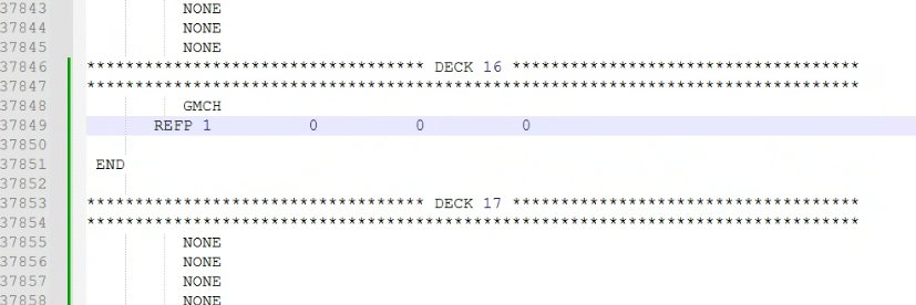

    • wsy1366
      Dear Mike,
      Thanks for reply.

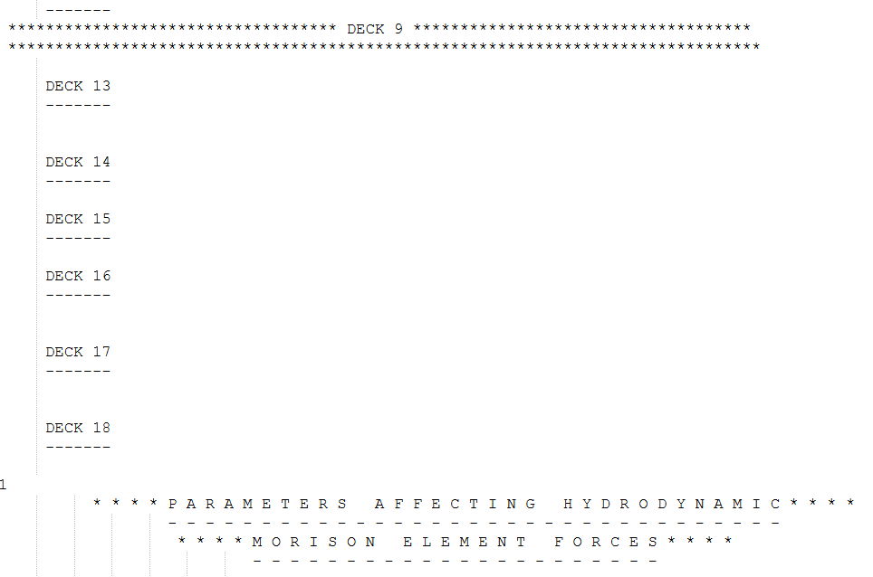

      I changed my Analysis.dat file down below:
      But there is no change at all and there is no results about DECK16 on "Analysis.LIS":

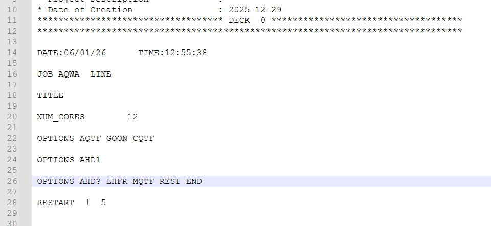

    • Mike Pettit
      First, please check that the SFBM option is not included in the OPTIONS at the top of the input file. This would disable any geometric changes that are defined in Deck 16 (GMCH). I guess this may be the case, as I would expect to see the REFP input reported under DECK 16.
      Once there is no SFBM option in your file, please scroll towards the bottom of the new Analysis.LIS, where you should find a section starting:
      * * * * ( C H A N G E   O F ) S T R U C T U R E   C H A R A C T E R I S T I C S * * * *
      Then you will find outputs such as 'TRANSFORMED STIFFNESS MATRIX', 'TRANSFORMED  ADDED  MASS', 'TRANSFORMED  DAMPING' and so on.
      Mike

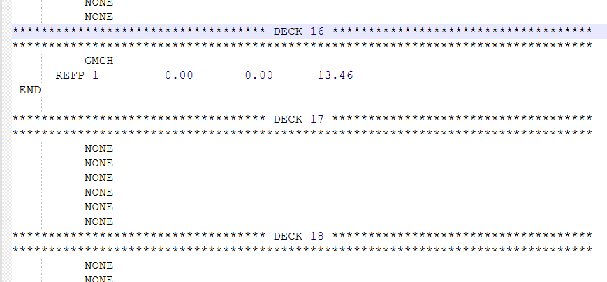

    • wsy1366
      Dear Mike,
      Thank you for kind reply.

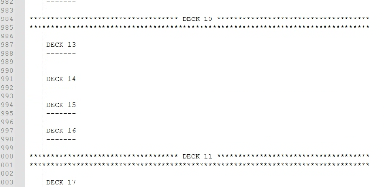

      As you can see, i deleted "SFBM" option from the text file(Analysis.dat) and executed again.
      (I wrote down [0, 0, 13.46] because i read that displacement is from original coordinate(C.O.G of structure), AQWA reference manual 25.7)
      I found out that there is no "SFBM" option anymore in result text tile(Analysis.LIS):
      But it doesn't change at all...
      I think i'm lost here.
      Is there any other options should i handle?
      Again, Thanks in advance:)
