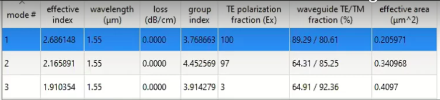

      I simulate a simple waveguide made of silicon in FDE (with a single wavelength of 1064nm). And get the different modes that can propagate in a cross-sectional area defined by the simulation region.
      I would expect that for propagation of a single frequency - the phase velocity and the group velocity would be the same. Because there is no group of waves - there is a single wave with a wavelength of 1064nm.
      Why do I get a big difference (factor 2)?
      In addition, I understand that in reality there is no single frequency but a finite bandwidth - and I would still expect it to be close and not twice.

      Although you are running a single frequency simulation, internally FDE calculates the modal properties at a neighboring frequency and then evaluates dw/dk to find the group velocity and then c/vg to calculate the group index.
      Do the other modal properties like effective index, losses etc. look accurate to you? Usually we recommend users to perform convegence testing to make sure that the simulation setup is accurate.

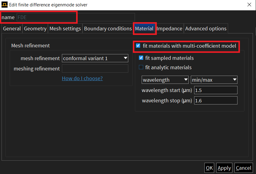

      Also, are you using dispersive materials? If yes, make sure you are using the "multi-coefficient model" for fitting the material data. This is because by default FDE uses a linear interpolation between the consecutive data points of the material data. So, if the default fitting is used the results of the frequency analysis (in this case for internal group index calculation) can be discontinous resulting in incorrect group index. The multi-coefficient model uses a single smooth fit for the material data instead.

      I tried changing to "Fit with multi-coefficient model," but I did not observe any significant change.
