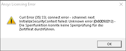

A customer of us has Problems while Licensing Spaceclaim. He gets the Message:Â Curl Error (35) SSL connect error...
When trying registation in a Dos-Command Window he see the same Message.
All Ports, listed in the forum, are not blocked.
-ansys-fno.flexnetoperations.com
-account.ansys.com
-login.microsoftonline.com
-subscription-api.ansys.com
-login.live.com
-ocsp.digicert.com
-c.urs.microsoft.com
Any Idea. what can he do ?

SubscriberThe customer uses Version: Spaceclaim 2021R2

SubscriberWe disabled Firewall - No it Works
