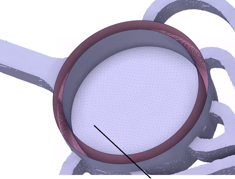

Forum ModeratorThe facetted geometry may cause some confusion, but I suspect the main problem is surface tool is identifying two circular faces rather than an annular face. The "practical" fix is to split the two lines at (for example) 0 and 180 degrees, connect the two pairs of points and then create two half-annular faces.Â
