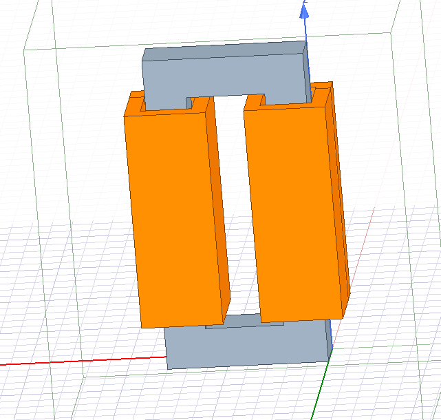

I'm new to Ansys Maxwell and I'm designing a single-phase UF core and I want to know how do I set a coil to be the secondary winding or the output coil?
I'm doing this design to learn more about the program to then design a three-phase EE core.
Here's a picture of my design, the right coil is the primary one and the left core is the secondary one.
August 18, 2020 at 1:43 amicellb
SubscriberHi,nKeeping the primary winding excitation setting as it is, if you are interested in voltage in secondary winding, you could assign an estimated current value as the excitation for the left coil. After running simulation, in result, you could choose to plot InducedVoltage(left winding name). Number of conductors is the number of turns.nViewing 1 reply thread- The topic ‘Core Design: How do I assign a coil as the output (secondary) coil?’ is closed to new replies.
