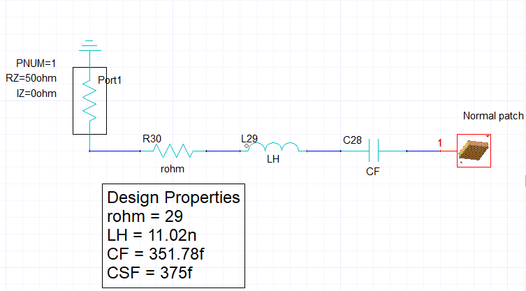

      So i have done my Q-matching to enhance a model of my probe-fed patch antenna and i have this:

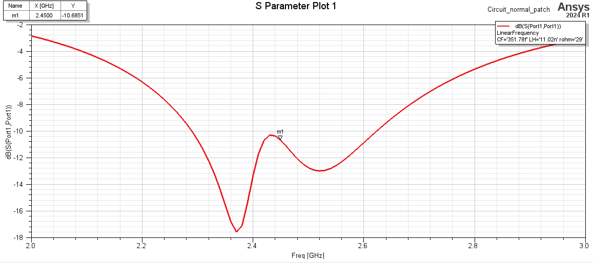

      With S11 results of:

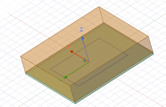

      mind you the patch antenna being matched is:

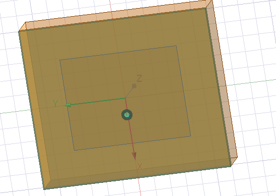

      A bottom view is:
      Where the ring you see at the bottom is the lumped port I defined for simulation.

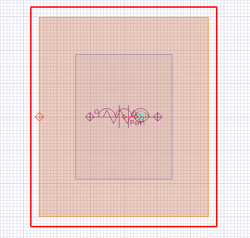

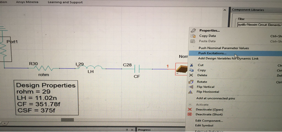

      My question is how to properly prepare this for fabrication through layout in HFSS circuits. I am still new to HFSS circuits so yeah, when I click on layout editor it shows me this:

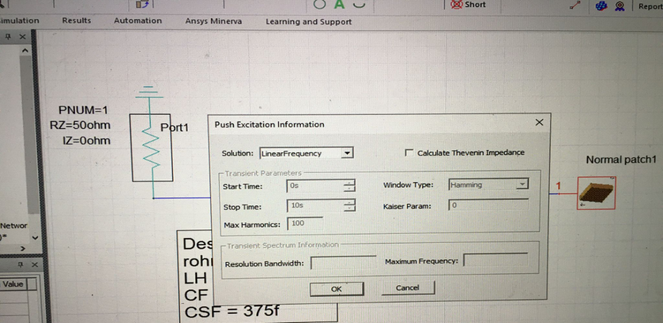

      so i am just trying to make sense of all of this, I have worked on layouts in ADS in the past but not extensively in HFSS. when I right-click on my imported antenna design it shows me an option to "push excitation" i assume to the original design like this:
      But my question is what will that do exactly? for the project i plan to end up using an SMP connector and its receptacle like this for feeding the antenna:

      For fabrication, you need to export the layout of your CAD model from Ansys HFSS. Please check with your fabrication team on which file formats are supported.
      You have designed a matching network in Ansys Circuit which means that this matching network will be connected externally to the antenna and can be connected after fabrication. This tool gives the combination required for the matching network but will not generate the layout for connection.
      If you intend to design the matching network on the same pcb of antenna then they should be added in the Ansys HFSS design itself.

        Okay, so how do I add the matching network to the ANSYS HFSS design itself? by pushing excitation? thank you.
    • Praneeth Munaga
      Hi Samad,
      "Push excitation" modifies the excitations in HFSS as per the response of the matching network.
      For designing the lumped elements required for matching netwrok, you can use "lumped RLC Boundary" in Ansys HFSS. Please go through the published papers and literature on designing the matching network.

      • Samad Atta
        Praneeth lumped RLC does not do series but only parallel so it's not the same. I explored the "lumped RLC Boundary" route before I embarked on my HFSS circuits journey.
    • Praneeth Munaga
      You can assign separate RLC boundaries for each of the elements and assign only a single element per boundary for each of the elements in your matching network and connect them. In the physical model, you will have these as individual elements rather than a combination.
      However, It is also possible to select series connection in the lumped RLC boundary window.
      Hope this helps.
      Best regards,
      Praneeth.
      • Samad Atta
        Yes i was thinking about the first suggestion you have for me but that can be faulty, about selecting a series RLC instead of a parallel/lumped one can you guide me on how that is done? thanks
    • Praneeth Munaga
      You can select the series or parallel connection in the Lumped RLC boundary window itself.
