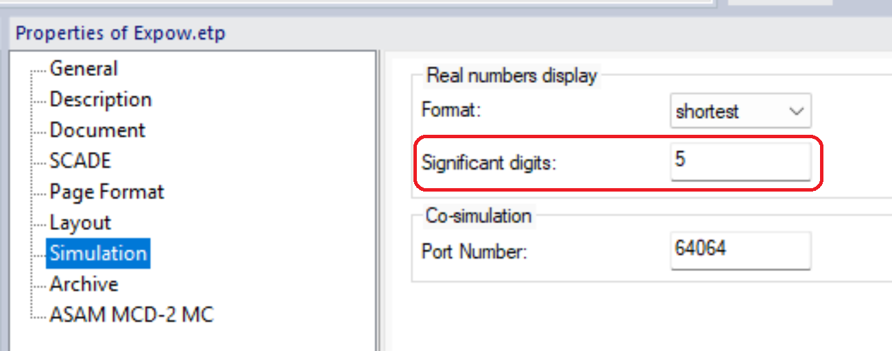

In any program (and not simply Scade), it is not recommended to perform such a comparison. Indeed float values depend on the processor precision. Then a "real" value 3.6 could be represented as 3.60000001 by a machine. As, in the Simulator, default precision for float values is set to 5 digits after the coma, this difference could not be seen.
In the properties of your SCADE etp project, you can change the number of digits used by the simulator to display real/float values. By changing the precision, you could check that the result of the comparison is really "false".

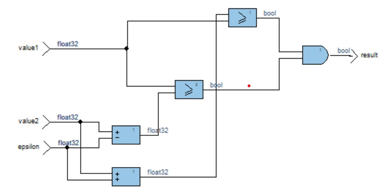

When your program requires to compare float/real values that are in a very close scale, it is rather recommended to protect the comparison operation by use of an Epsilon precision: "B == A +/- Epsilon". Example1:

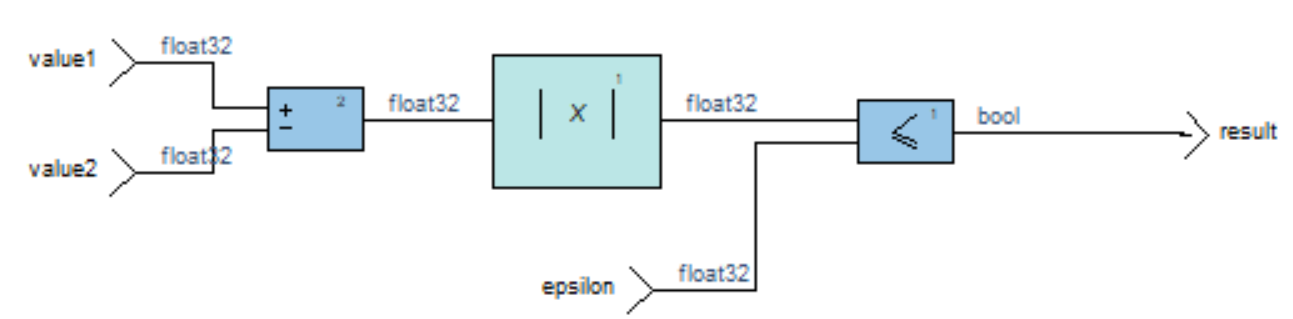

Here is another possible implementation. Example2:
