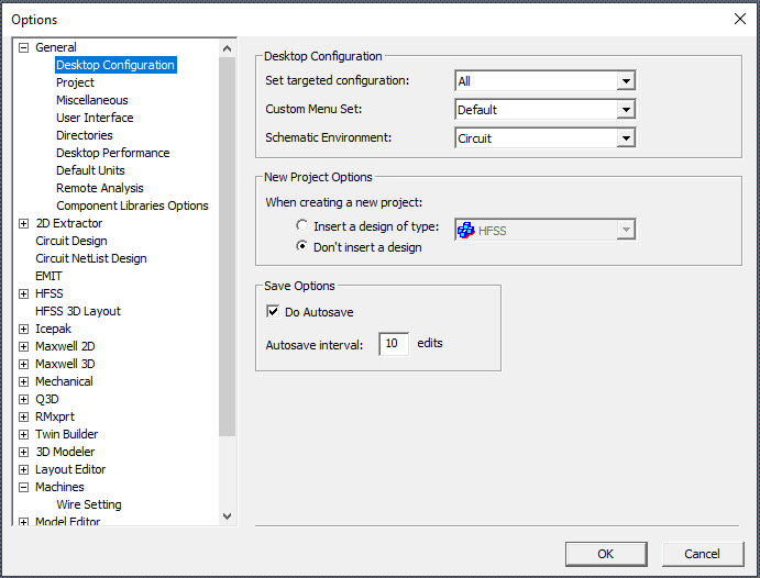

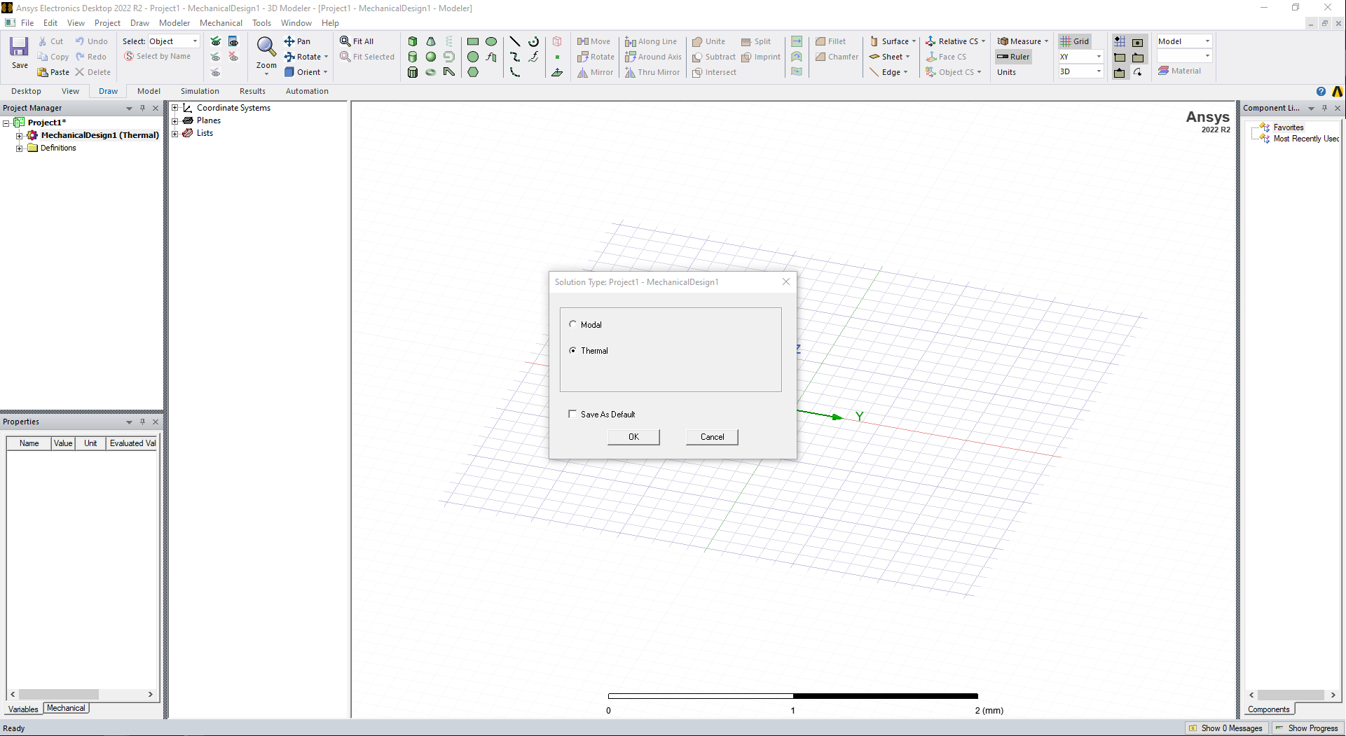

      Thank you for your response. I have installed Ansys Electronics Desktop 2022 R2. I believe that the latest version. When I insert a mechanical design in Ansys electronics, I only see an option for thermal and modal for solution type. I don't see an option for structural. I have attached a picture below. Can you guide me on how I can create this mechanical deformation in Ansys Electronics desktop? On Ansys Help, I read about "Structural Solutions (beta), " a new type of solution type in mechanical design in AEDT. However, when I checked Option -> General -> Desktop configuration, I didn't see any option to enable the 'Beta option'. Note: My license is provided for research by my university.

      Just want to let you know I was able to solve the previous inquiry about not seeing the "Beta Option" in the "Options setting in Ansys Electronics Desktop. After a few steps, I encountered another issue. I am getting this error message when I run my design in Ansys HFSS coupling with Mechanical. I have attached the error message screenshot below.

      For structural solutions in AEDT, you do need the Mechanical PPE license along with the Electronics license. Mechanical Thermal can work with the Icepak license but structural needs the Mechanical license. Please reach out to your IT to ensure that you have the license.

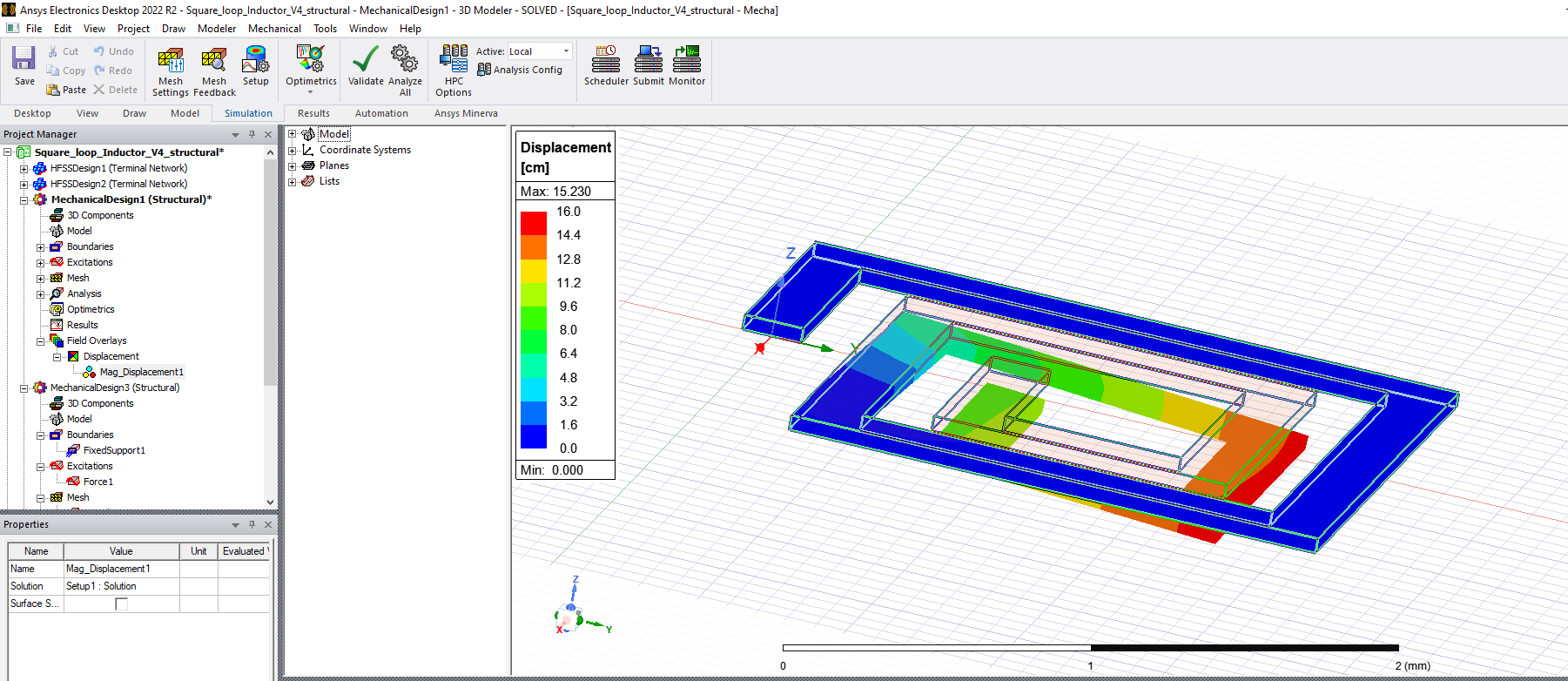

      In Ansys Electronic Desktop, I was able to create the deformed geometry of the spiral as shown in picture 1. However, how do I now export or take that "deformed geometry" into the HFSS design for further EM analysis?
      Thank you,
