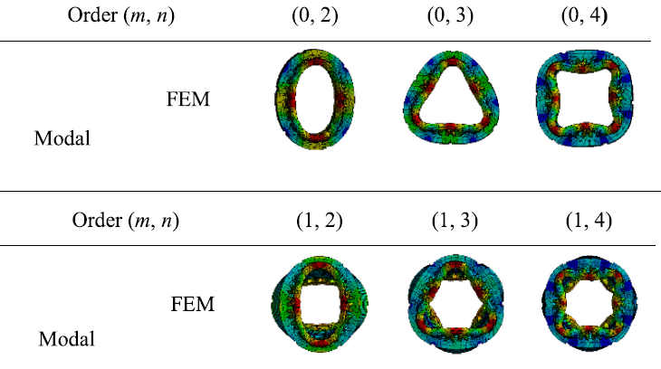

      I have conducted a modal analysis using ANSYS Mechanical and I have filled the the maximum number of modes in the analysis setting section. Referring to the figure below, ‘n’ represents the circumferential modal order, and ‘m’ denotes the axial modal order. With regards to this, what does “maximum modes to find” refer to, which I have inputted during the modal analysis? Also, how can I modify the ‘m’ and ‘n’ modal orders in the modal analysis settings?

      When you use modal cyclic symmetry the modes are extracted one circumferential mode at a time.  In a full model the program doesn't know what m and n are for a given mode.  You just have to determine that by observation (as you have done.)  "Maximum modes to find" is how many modes will be extracted.  It's worded that way because sometimes the solver finds less than the requested number of modes.

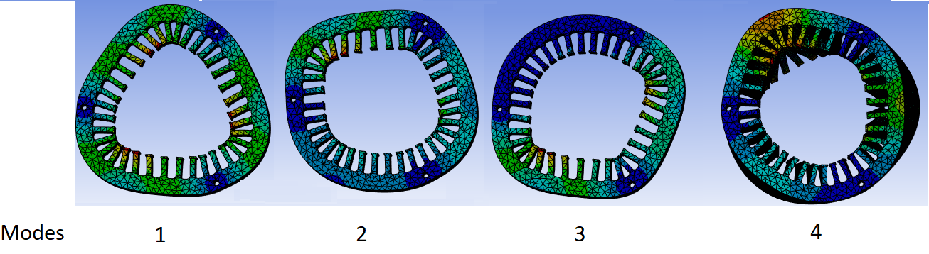

        Thank you for your response. Here, you can see the results for the four modes. According to your comment, the results are for the zero circumferential mode, am I correct?

      Those modes don't look like harmonic index or nodal diameter 0.  More like harmonic index 3.
