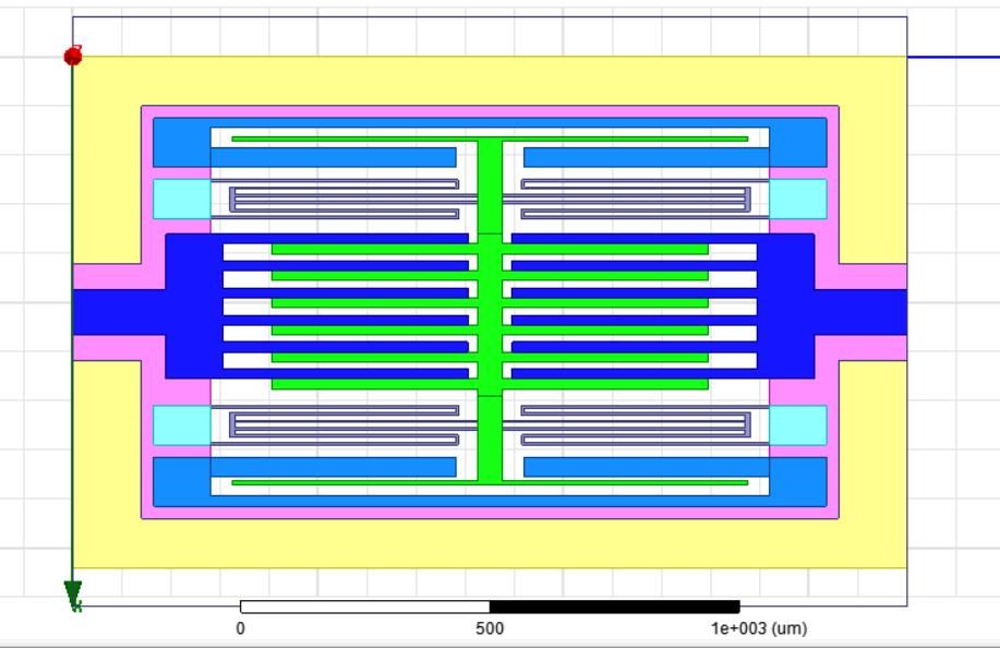

Geometry: I'm currently in the driven modal solution mode and the dimensions in micrometers. The figure below shows the geometry's top view. It consists of a 5G SOIMUMPS switch composed of a coplanar waveguide. The green comb-like inner structure are the actuation electrodes whereas the dark blue electrodes on either side are the signal electrodes. The actuation electrodes are touching the signal electrodes in this ON state completing the signal path and conducting the signal. The yellow external structures on either side, are the grounds of the coplanar waveguide. All structures are made of 25um Si in accordance with the SOIMUMPS process on top of 400um Si substrate and 1um Silicon dioxide layer. On top of the ground, signal lines and inner actuation electrodes a 0.65um layer of gold has been deposited for conducting the signal.

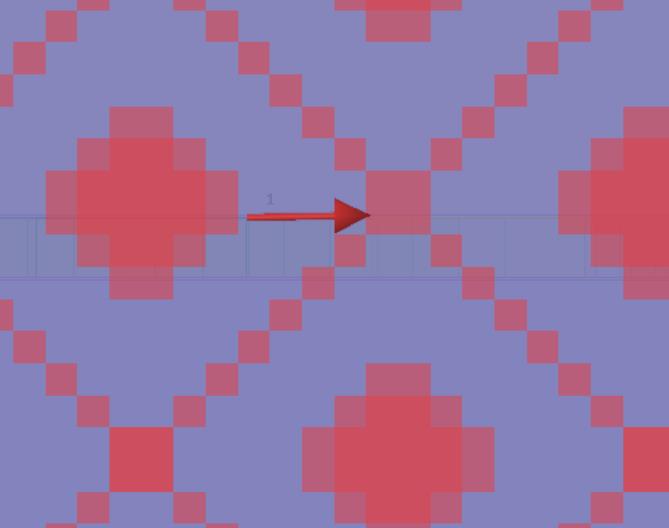

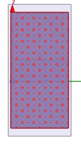

Excitations: I have made two rectangles on the cross-section of the device on the face of the airbox and assigned them wave port excitations as shown below.
The integration line is defined from the top right-hand edge of the signal line to the top left-hand edge of the adjacent ground. I understood that the integration line is to be defined across the region of the highest potential difference hence I drew it from the signal line(highest voltage) to the adjacent ground(0V) on the right-hand side. However, I'm not certain how to encompass both grounds(left and right) into this. The number of modes is kept to 1. I have repeated this for the rectangle on the output port.

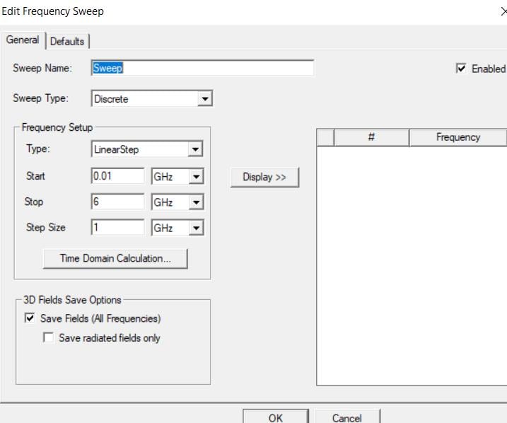

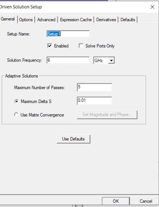

Solution Setup: I have added a solution setup and frequency sweep as follows:

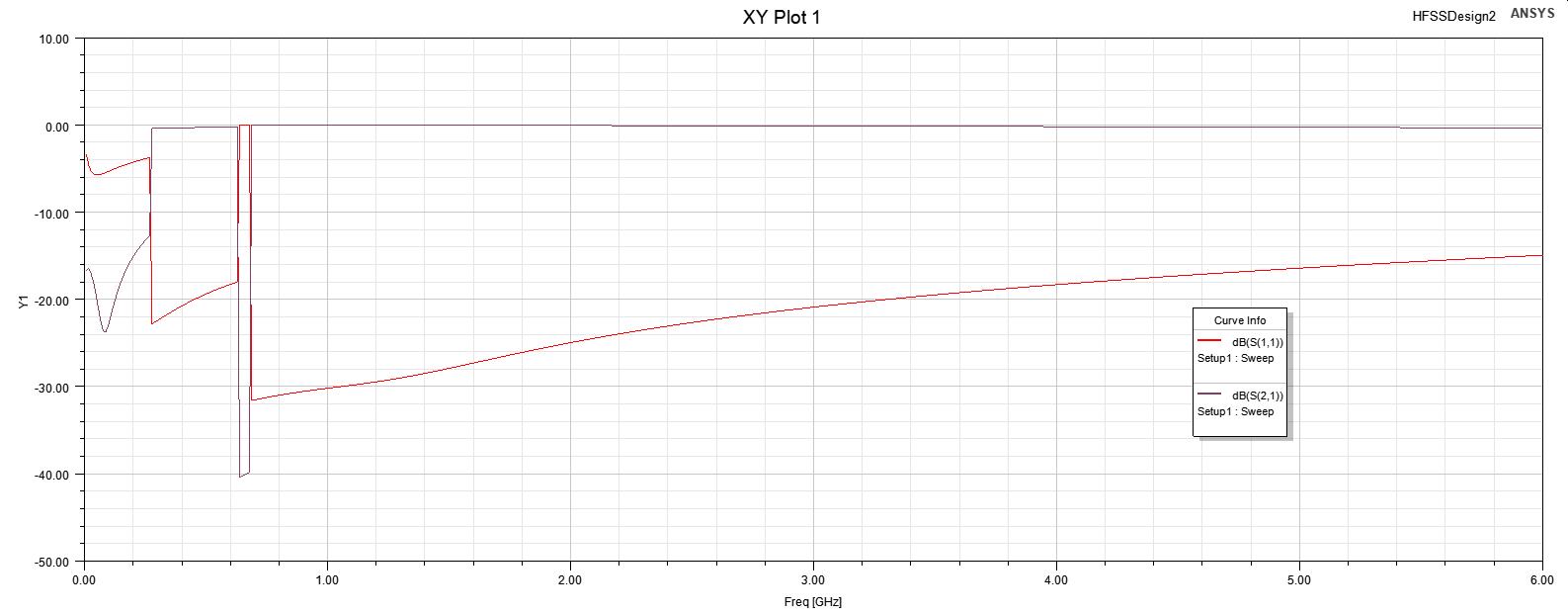

Otherwise I ran your model in the curent version 2019 R3 and the results look good:
I did use the new Broadband Adaptive Mesher - but your results at 6GHz should be nearly the same. - If not, plot the mesh on all the surfaces and look to see if perhaps some features are not being captured properly...
EDIT: Apologies for the low resolution image upload, it's a limitation of the forum - My results were S11 = -14.9dB and S21 = -0.4dB @ 6GHz
