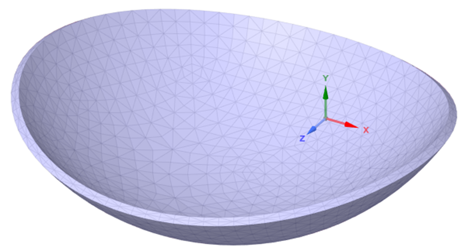

Since Rob brought it up, I can walk you though the many steps that should result in being able to export an STL file after you build and mesh a model.

I opened the Workbench from the Start menu. I then found the Steady State Thermal item in the dropdown list on the left, and clicked it. A new window opened in the work space. I then hit the import tab and brought in my sample solid file. Again, it appeared as a new small window in the workspace. I could go no further. Nor could I see how to turn the solid into a mesh in Workbench, although it’s easy to do in Spaceclaim (use the facet tab).

SubscriberRight click on the Geometry cell A3 and Import the SpaceClaim file that you previously saved.
Then double click on the Model cell A4 to open Mechanical.
August 13, 2023 at 5:14 pm
Tomkay687
SubscriberWow. Finally. Nothing about that was intuitive for me. I finally hit enough buttons and options to find a way to export an stl file of my simple cube sample model. I imported it into Rhino to verify that it actually worked.

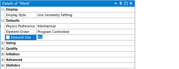

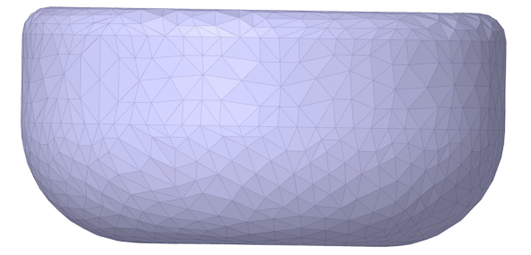

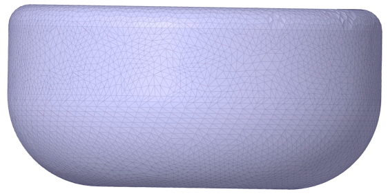

I did a second sample piece of geometry and it worked. The only issue I see with my newly exported stl, is that it's very rough, what I call faceted.
Is there any way to boost up the resolution on the part either just before, or during the stl export ? If I were printing this part, it would still end up quite rough.
