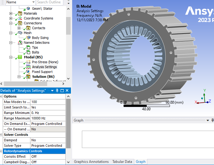

SubscriberHello, everyone.
I am attempting to calculate the natural frequency of the stator and frame of an electric motor to validate my analytical results using ANSYS Modal analysis. I have assumed that the four bolts on the motor frame act as fixed supports and have considered a maximum of 100 modes to determine the frequency range up to 10kHz in the analysis settings. After solving, I have inserted the deformation for each mode. Here, you can view the tabular data. I am concerned that the natural frequencies for each mode may be incorrect because I calculated the natural frequency for mode 1 to be about 500Hz. Is this the correct method for calculating the natural frequency of any structure in each mode?

Ansys EmployeeHi Hamid,
Based on the information provided in the context, the method you are using to calculate the natural frequency of the stator and frame of an electric motor seems to be correct.
Will you please review your analytical calculations as well as the boundary conditions that you applied? Will you please share the screenshot of the model analysis so that we can review the model and boundary conditions?

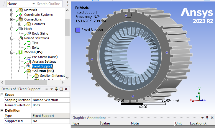

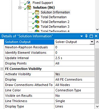

SubscriberHello Sampat,
Thank you for your response. I’ve reviewed my analytical calculation. For example, in mode=1, the simulated natural frequency value differs significantly from the analytical calculation. Here you can see the screenshot of the model analysis and boundary conditions. Can you help me figure out where my fault is?

Ansys EmployeeIt’s difficult to assess the situation without a model. Perhaps outside of an ANSYS employee could assist you by looking at your file. As for your procedure, it seems no major issues present. However, I have some suggestions for you to consider:
- I have some doubts about the results of your analytical calculations and the assumptions made during them.
- I recommend double-checking the material properties and units used.
- The boundary conditions (fixed support) and contact stiffness of the bodies could be potential sources of the problem. It will change the stiffness of the model, which will affect the result.
- Do the mode shapes from ANSYS match your hand calculations?
If possible, would you please attach a screenshot of the hand calculation to give me an idea of the stiffness you used and how you have considered it.
