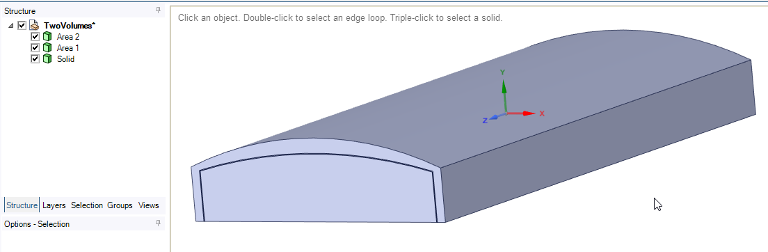

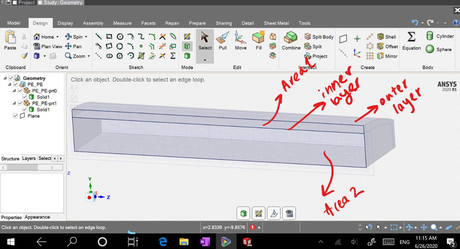

      I am trying to model an overly-simplified version of a greenhouse. The main goal is to see the effect of the type of the materials used for the inner layer cover on the temperature of the air inside the greenhouse. I attached the geometry that shows the two regions/volumes of air inside the model. what I need is to build a layer (with finite thickness and assigned materials) in between the two air volumes inside the greenhouse and a layer on top of the greenhouse. Is there a simple way to do that in Discovery without messing up the mesh? I attached a picture of targeted layers within the model. In the picture, Area 1 and Area 2 are the volumes built in the geometry file, and the outer and inner layers are the boundaries that I want to build. Thanks.

      I noticed that you have performed Share Topology operation between the 2 bodies. Since we need to create additional bodies, unshare all the faces and edges.

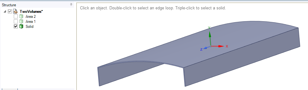

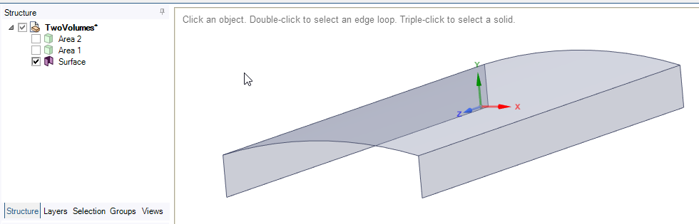

      Select the 3 inner layer faces of any body. Then right and select Copy, and then Paste. This will create a new surface body for the inner 3 faces.
      Hide the 2 solid bodies, then click the Pull tool and select all the 3 faces and pull them by an appropriate distance. This will create a thin solid body. You may want to enable Symmetry option from the Options panel if you would like to pull the faces symmetrically on both sides.
      Next, display all the 3 solid bodies and click Interference tool from Prepare menu and click the check mark button to complete the operation. You will now see the thin layered volume between area 1 and area 2.
      Follow similar operations to create thin layered body on the outer side.
      Regarding meshing, since the geometry is modified, you will have to remesh the model. Additionally, since you now have thin bodies in the geometry, you will have to ensure minimum 3 mesh elements across the thickness which will increase the mesh count.
