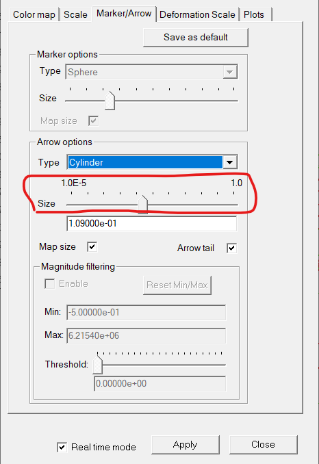

    • Navya Chode
      HiEmilyJennings ,
      To change the appearance of a vector field plot's arrows:
      1) Click Maxwell3D or Maxwell2D and selectFields>Modify Plot Attributes.
      The Select Plot Folder window appears.
      2. Select the plot folder you want to modify, and then click OK.
      A dialog box with attribute settings for the selected folder appears.
      3. Click the Marker/Arrow tab.
      You can change the size of the arrows or change other options as required.

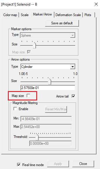

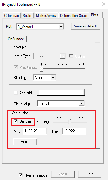

    • DELI
      Hi EmilyJennings ,
      For display, I have to suggestions:
      1 uncheck "map size" in Marker/Arrow tab, that usually will changing off scaled arrows for display.
      2 uncheck Uniform in Plot tab, that usually matches the arrow size to field amplitude.
      For simulation accuracy, I will suggest refine mesh or heal geometry, an off scaled arrow could be caused by a non-sufficient mesh or geometry issue.
