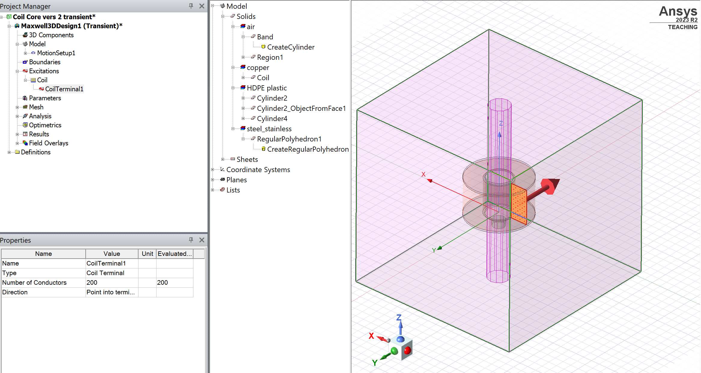

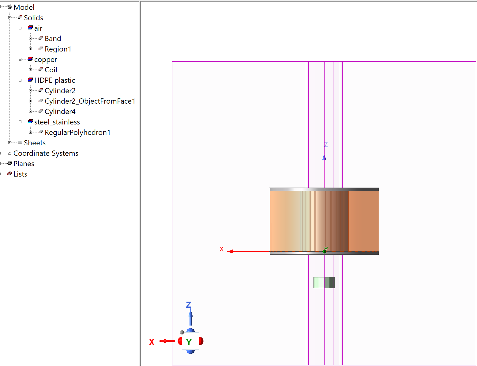

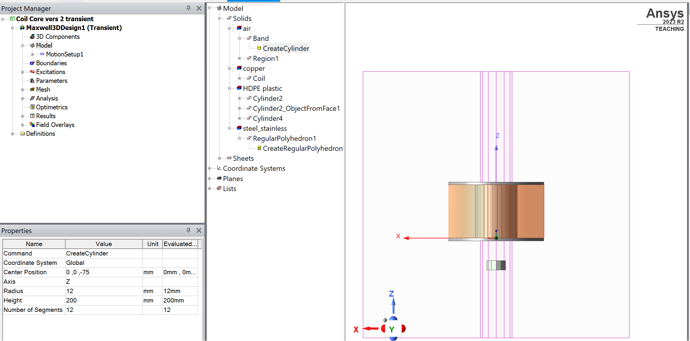

        1. I’ve completed a tutorial on transient analysis. The tutorial specifies that a spherical steel ball cannot be used due to the cylindrical nature of the motion setup. Instead, a polyhedron is recommended for both the band and the steel ball. Both the polyhedron band and steel ball consist of 12 segments each, as shown in the picture below. Is this accurate? See in the picture below here:

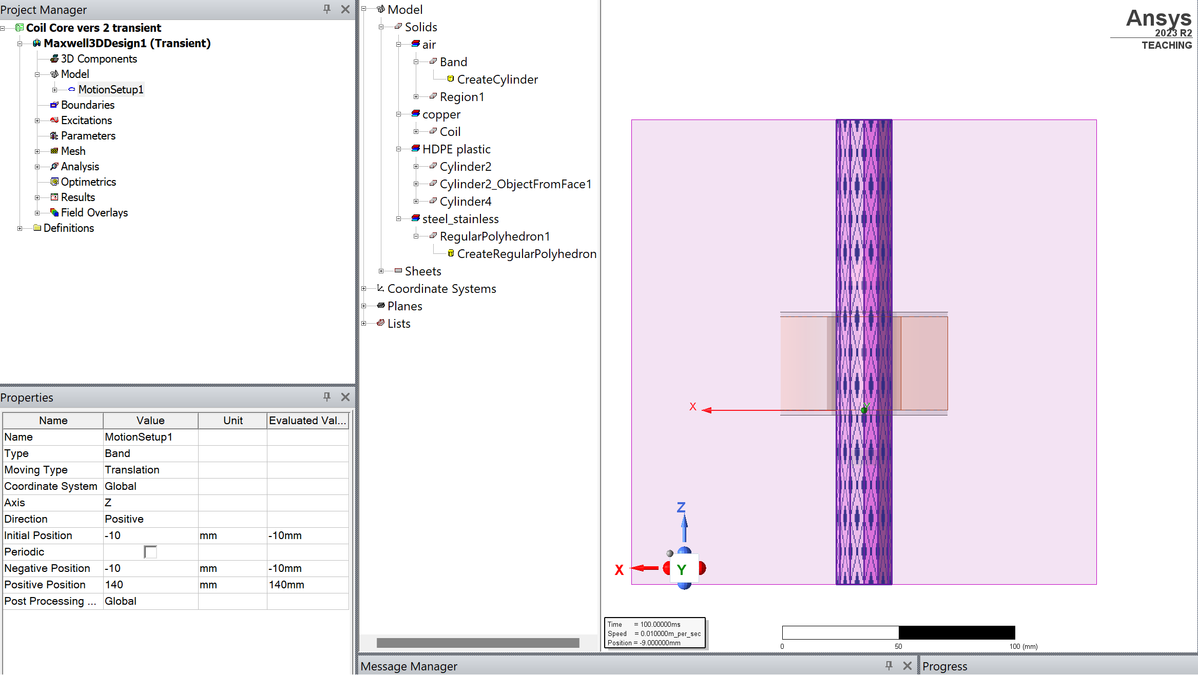

        2. During transient analysis of the figure, the polyhedron steel ball is observed to travel only from its initial position in the figure to the midpoint of the coil core. why? See below the picture for the band property:
        the band properties
        the motionsetup properties: I cannot make positive position larger because I would get error: “Positive motion is too large”

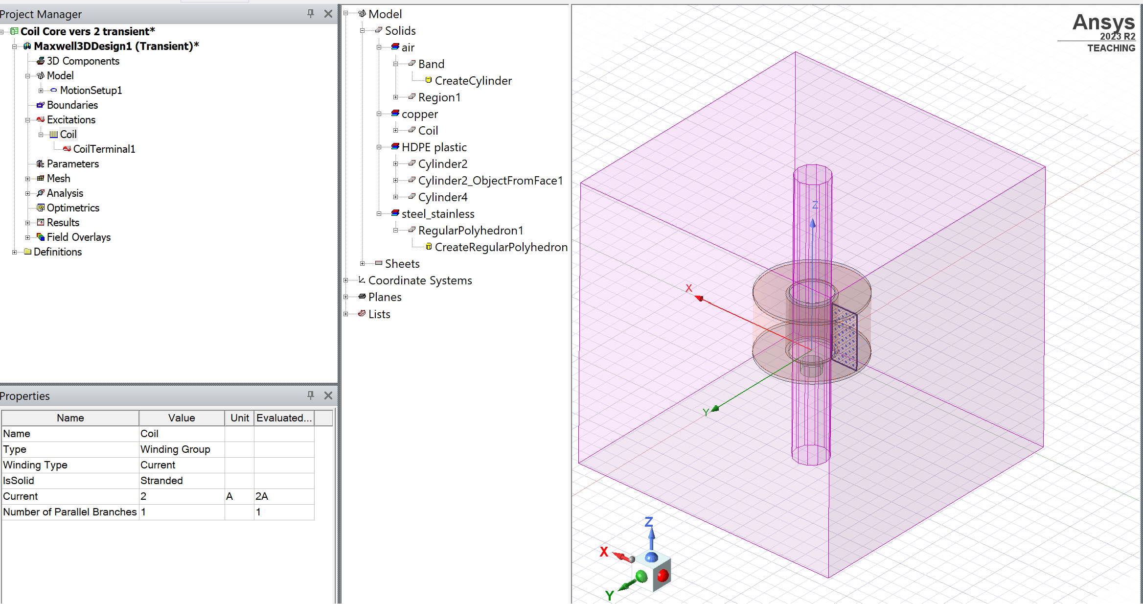

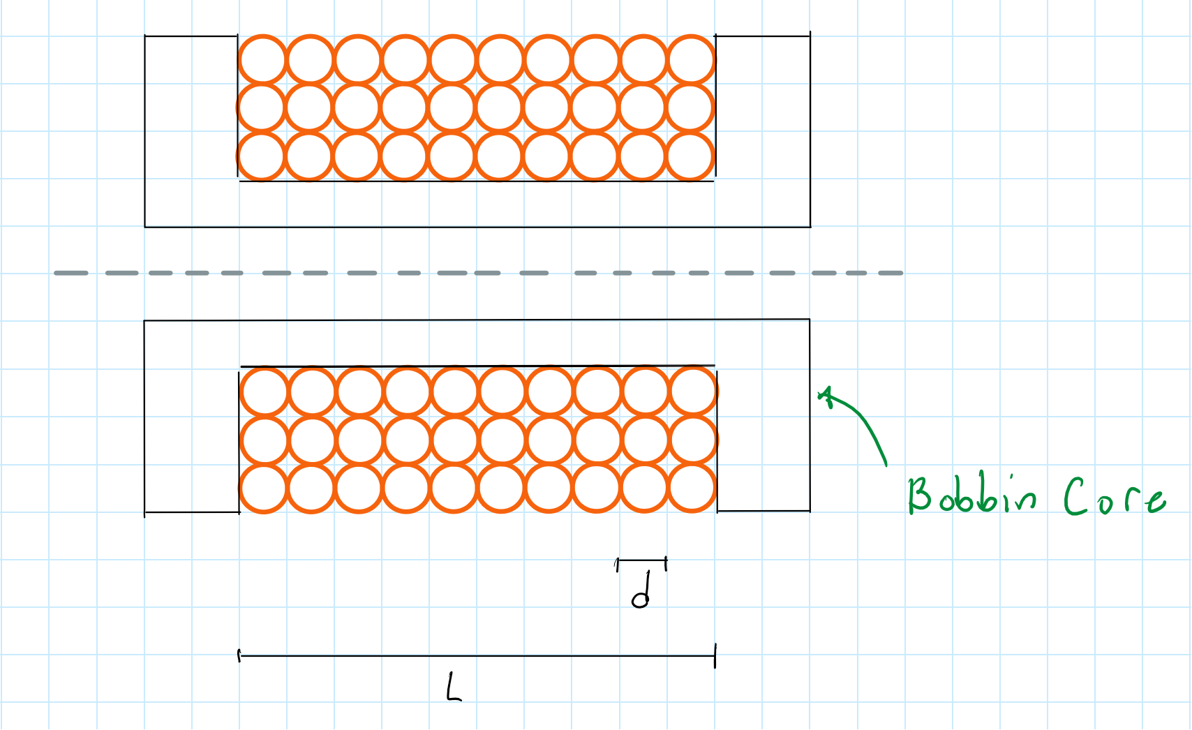

        4. I think I might be mistaken in my approach to excitation and the number of conductors. I am attempting to create a coil featuring a single copper wire with n turns and multiple layers, as in the figure below.
        Here are the properties for the Excitation
        Properties for the Coilterminal1

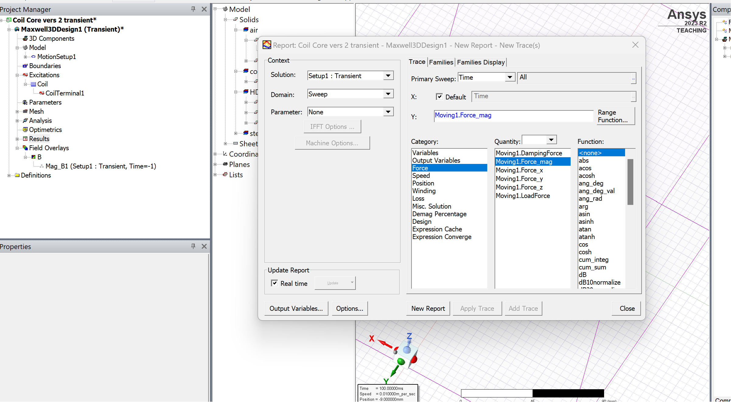

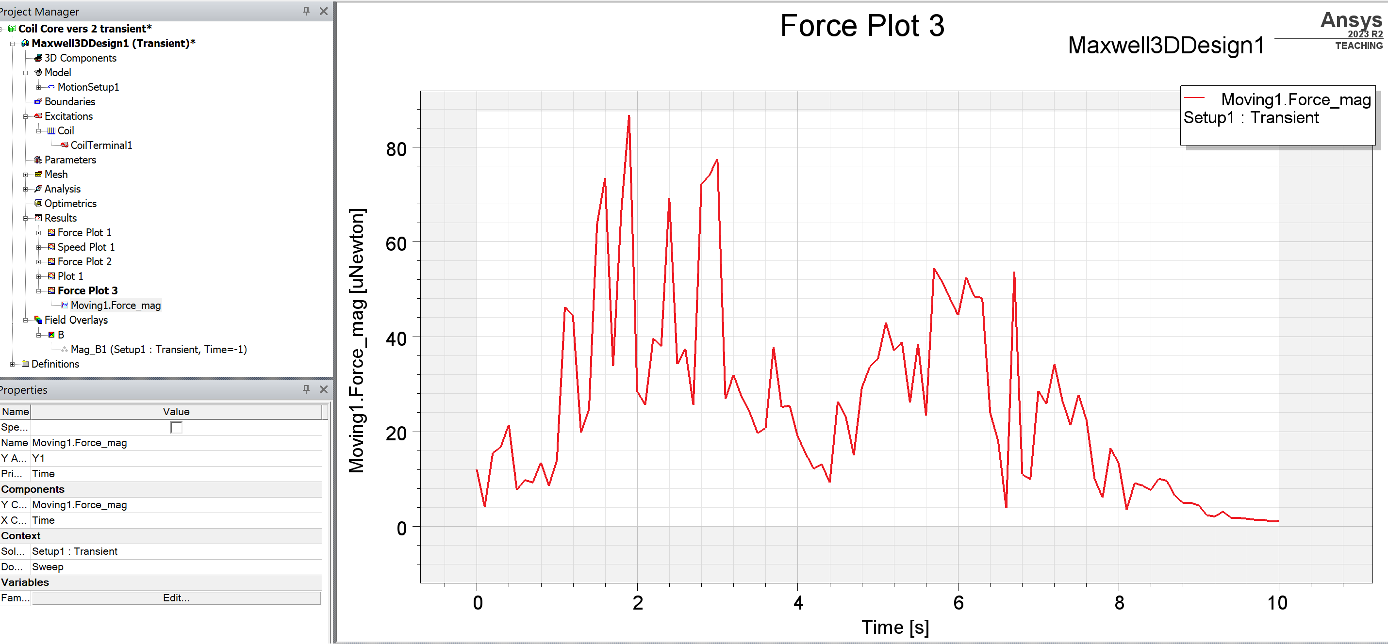

        5. When doing simulation and want to check the magnetization and the force of the “polyhedron” steelball , I am not sure where I can find it or how exactly how to do it, this is what I did for now:
        I clicked the following: Maxwell 3D -> Results -> Create Transient Report -> Rectangular Plot

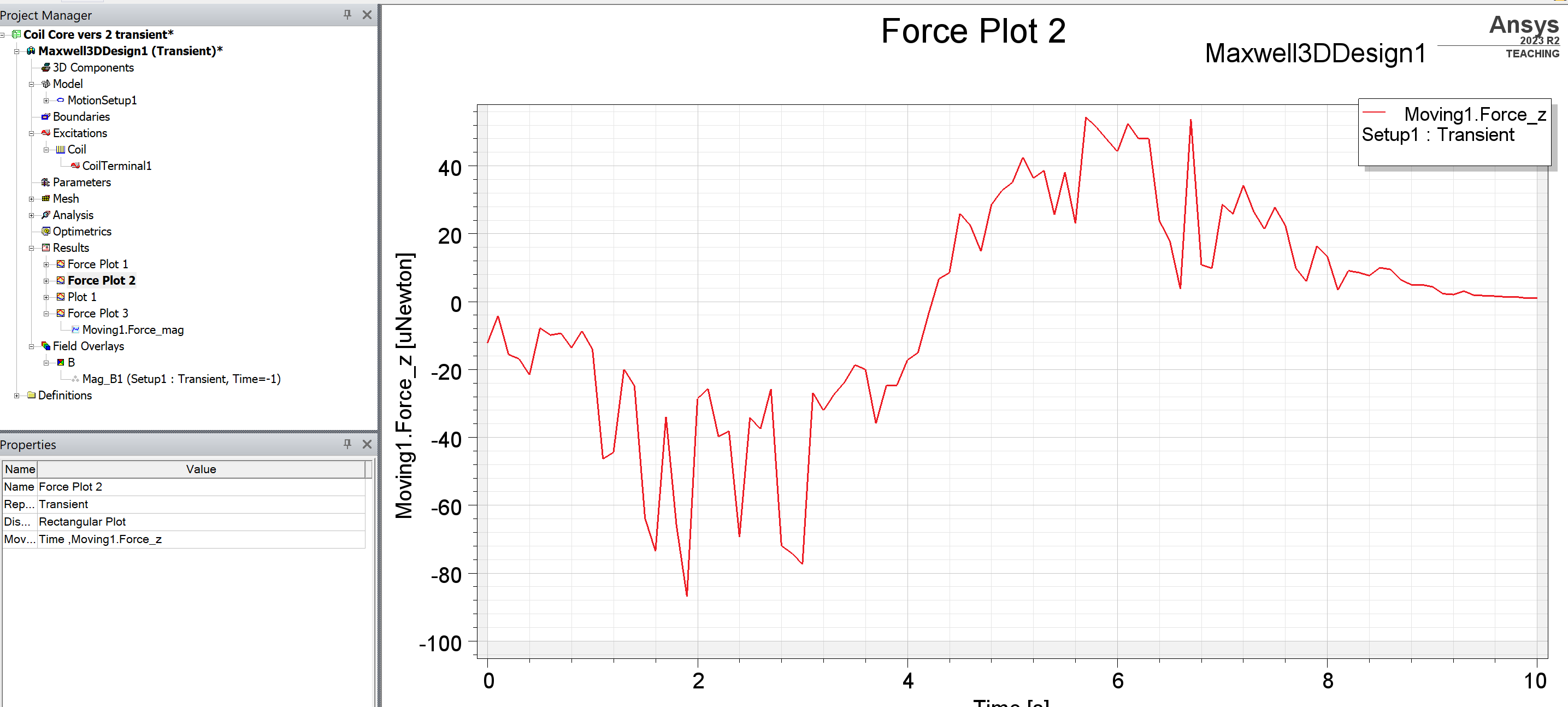

        this is what the plot of mag force shows which kind of looks very weird for me… also note: The steelball only goes halfway through the coil
    • Marcus Johansson
      Continuing here:
      The plot for Force z shows here which is also a bit weird looking

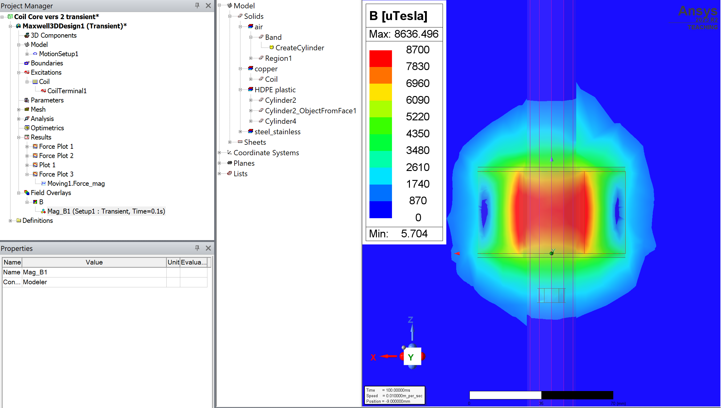

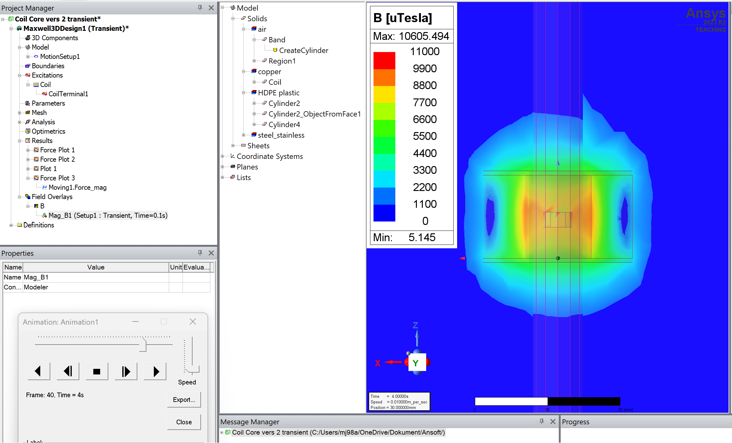

      6. Magnetic field magnitude
      With animated one here below, and it show magnitude B=10 mT
      The "polyhedron" steelball as I said above does not go through the coil core completely.
      No animation: B magnitude shows 8,6 mT why? and it seems that polyhedron "steelball" does not affect the magnetic field despite having material stainless steel why?
