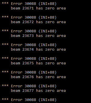

      I'm simulating a solid object impacting a beam element mesh in LS-Dyna.
      I created the mesh in WORKBENCH and exported it to a K-file.
      I've set everything up, but when I run the calculation, I get the error:
      Why? The mesh was created for beam elements.
      Please help.
    • Vijay
      Hello Javat,
      It seems the error might be due to missing cross-section properties. Please verify the Section card for the Beam element.

      • javat33489
        Thank you for your reply, sir.
        Please tell me where exactly I can do this? On which map?
