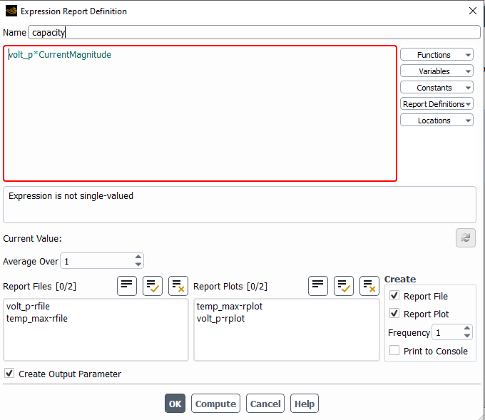

How to generate graph of voltage vs capacity of battery during discharging ?
How to make connection file if i want to use virtual battery connection ? -

You can look at 27.2. Using the MSMD-Based Battery Models (ansys.com) to make a virtual battery connection.
You can create Report Definitions for voltage and capacity and then plot them in Report Plots under Monitors. Please look at 4.11. Postprocessing Results (ansys.com) for more information.

Can you please describe more about how to make report definition for capacity as i am unable to find capacity variable among battery variables provided ?
( There is SOC variable available but not capacity ) -

Ansys EmployeeIf you cannot find a variable, you can create it using Named Expressions.
