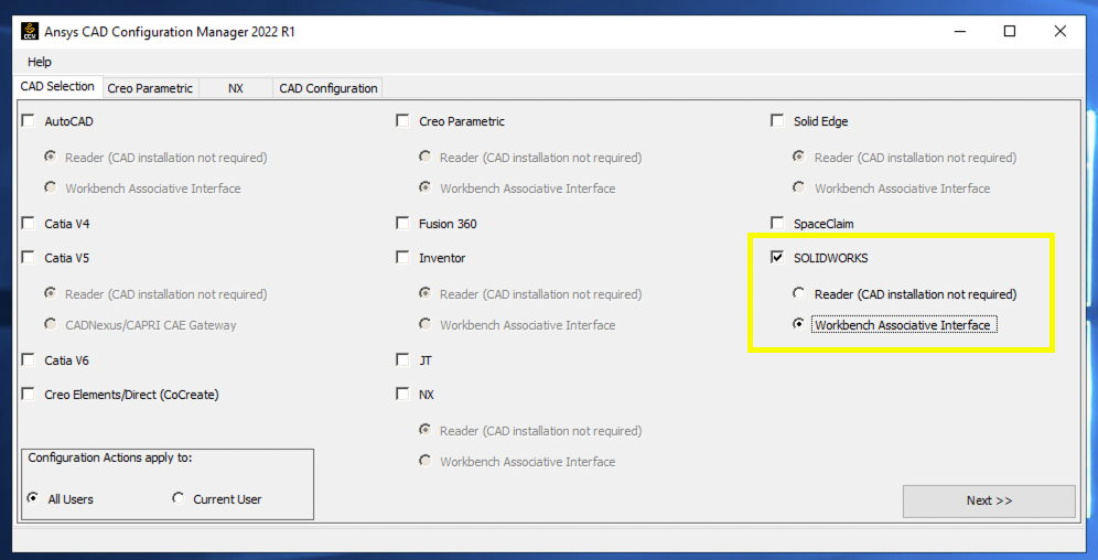

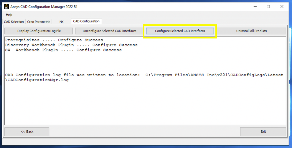

      Hello -
      We installed Ansys in a computer lab and discovered that we need to go through CAD Configuration Manager to Configure the Solidworks Associative Workbench Interface. Given we have about 40 computers in the lab, I'm hoping to automate or script something so I don't have to login to each machine with admin rights and do this process manually. Has anyone had success in doing something like this?
    • George Karnos
      If the Solidworks Associated Interface is installed during the initial Installation,
      CAD Configuration should not be needed to be run on each machine. It should be configured during
      installation.
      To script a silent installation, please check chapter 7 in the Windows Installation guide on Silent Product Configuration.
