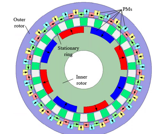

      please how do we assign magnetization to the halbach array magnets in the figure below in ansys maxwell.

      Hello Ebenezer,
             You could select object by using Face or object selection, and then define Face CS or object CS for each magnet. Finally please use Face or object CS for the magnet magnetization.

      Thank you Sir for the swift response .please can you kindly help me  on how to enter the  specific energy (BHmax), Curie point
      temperature and specific electric conductivity of a particular magnet material in ansys maxwell .Thank you

      Hello Ebenezer,
             Please open material definition and you will find what are required for the magnet material, like ur, Hc, or BH curve, etc., and some parametes are not necessary for EM simulation like curie temperature, etc.
             I think the key is to define magnetization direction for your project, please see this /knowledge/forums/topic/how-to-model-multi-directional-magnetization-of-pms-in-maxwell/
