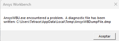

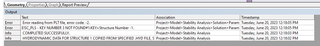

Ansys EmployeeHi, Eugenio, it looks like something went run with the structure in the model or the result file hadn't been fully written out. As I don't know what exact steps you went through, I am not sure what exactly caused it. My suggestion would be have a check of the .MES file and .LIS file to see if there are any useful messages. Also, check your geometry components, Structure Selection, and re-run Hydrodynamic Diffraction and HR stability analysis. If possible, start a new HD and HR to try again. If this continues to happen, please let me know the detailed steps you went through to reproduce this problem. Hope this works.

SubscriberHi Yu. Thank you, I solved it. It was a Structure-Selection problem. In the case this error appears again, or for future similar errors: could you please briefly explain how to check a .MES/.LIS file? How is it opened and reviewed?

Ansys Employee.MES/.LIS files are in the solver file directory (you can find the path from the details panel of Solution). .MES file contains messages. .LIS file contains the results and also information, warning, and error messages.
