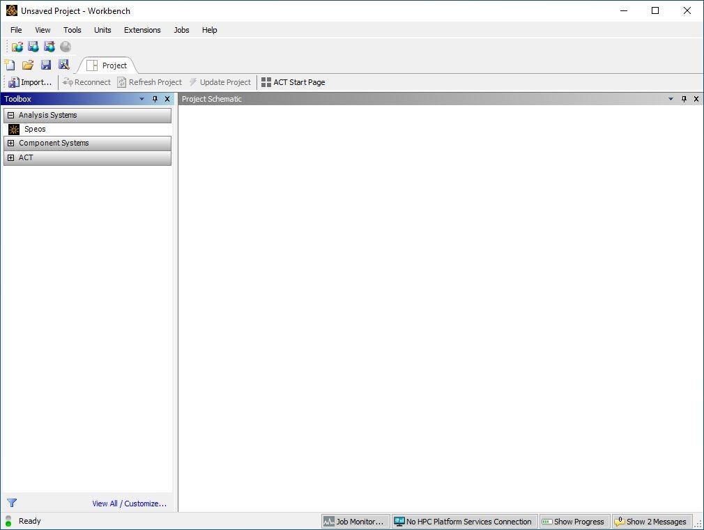

SubscriberI didn't realize, after the fix we applied the error for workbench upon launch is a bit different now:
"Workbench could not connect to a valid licensing server.
Review your license configuration in the Ansys Licensing Settings application and make sure you are connected to a valid network."Then the application opens just fine, but it's missing features.
October 29, 2024 at 3:40 pm
Rajeshwari Jadhav
Ansys EmployeeMay I know which all features it's missing?

Ansys EmployeeThis is not a student version correct?Â
October 29, 2024 at 4:04 pm
Rajeshwari Jadhav
Ansys EmployeeIf it's an academic version then can you please goto Current Release, download and install service pack as an admin. This issue is resolved with SP3.
October 29, 2024 at 4:59 pm
lbartosik
SubscriberIt's academic version. Let me give it a try.

Ansys EmployeeDo you have any other version installed? if yes then please follow the below suggestion:
Go to ' C:\Program Files\ANSYS Inc\v242\Framework\bin\Win64' and rename 'Ans.Core.Components.dll' to 'Ans.Core.Components.dll.old'
Copy the Ans.Core.Components.dll from C:\Program Files\ANSYS Inc\v2xx\Framework\bin\Win64\ (working version) and paste it to ' C:\Program Files\ANSYS Inc\v242\Framework\bin\Win64' -

SubscriberI copied it from v232 to v242. I'm not sure if mixing versions is ok, however I got Unhandled exception upon launching Workbench.

Ansys EmployeeDidn't you receive any mail from our end?
November 8, 2024 at 8:38 pm
lbartosik
SubscriberYes, got it just now and implemented it. It works! Thank you.
