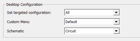

- Open AEDT Student (for your case it will open the Twin Builder interface), and click on Tools > Options > General Options. In the 'Desktop Configuration' settings, select 'All' for 'Set Targeted Configuration' and 'Default' for 'Custom Menu'. Click OK and restart the AEDT Student 2023R2.
