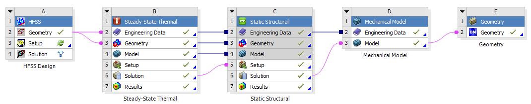

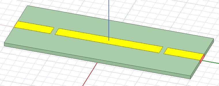

      Using a very basic model (a dielectric slab with three thin, conducting strips), I use HFSS to create my initial geometry (out of familiarity). I link it to "steady-state thermal" and "static structural" modules and perform those simulations to get the deformed geometry, which I then export to a "mechanical model" and then finally to "geometry". I've attached an image depicting this linking in Workbench.
      Original geometry:
      Workbench flow:

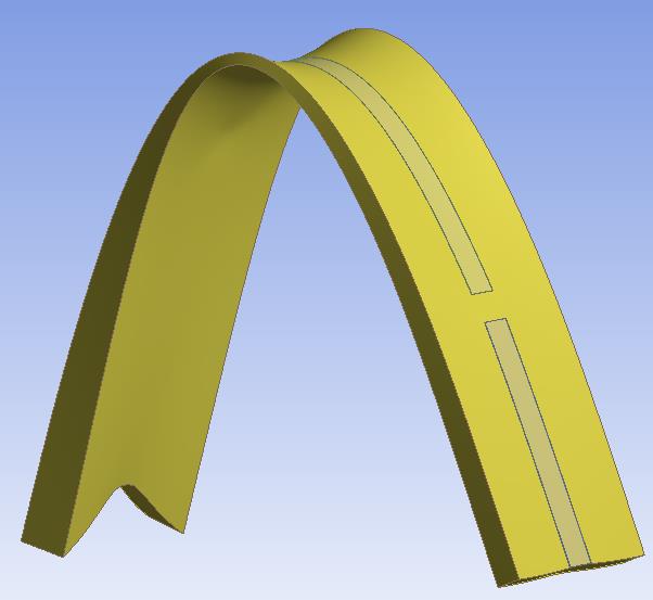

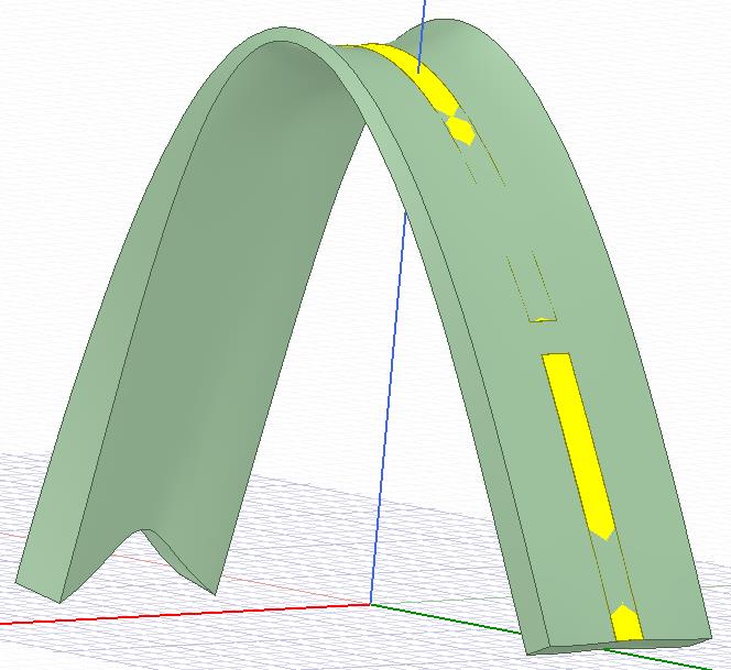

      Opening the final "geometry" with DesignModeler, the model has the expected deformation and there appears to be no undesired gaps or intersecting geometry. If I export the model to file and then import it into a new instance of HFSS, the geometry appears similar to how it did in DM, but with intersecting geometry and/or gaps. I'm not sure whether the problem has something to do with the quality of the export/import process, or if it is a problem in the structural stage of the simulation (such as contacts or boundary conditions).
      Deformed geometry in DM:
      Deformed geometry in HFSS:
      Intersection/gaps aside, another complication in HFSS arises when it comes to defining the ports, as the surfaces aren't planar in the deformed geometry. Is there a way to simply preserve an area of the geometry from deformation or is some sort of geometry truncation necessary before analysis in HFSS?
