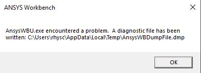

      I am following the video tutorial and I am up to the stage where I double click 'model' to open Ansys Mechanical. It opens a plain grey window but the program never materializes. After minutes of waiting (one a modern, powerful PC) I close the grey window and I get an error in the main workbench window that says:
      " Error while waiting for Mechanical initialization to complete. Either the application crashed or Workbench lost communication with it."
      Has anyone else had this issue and if so, how have they resolved it?

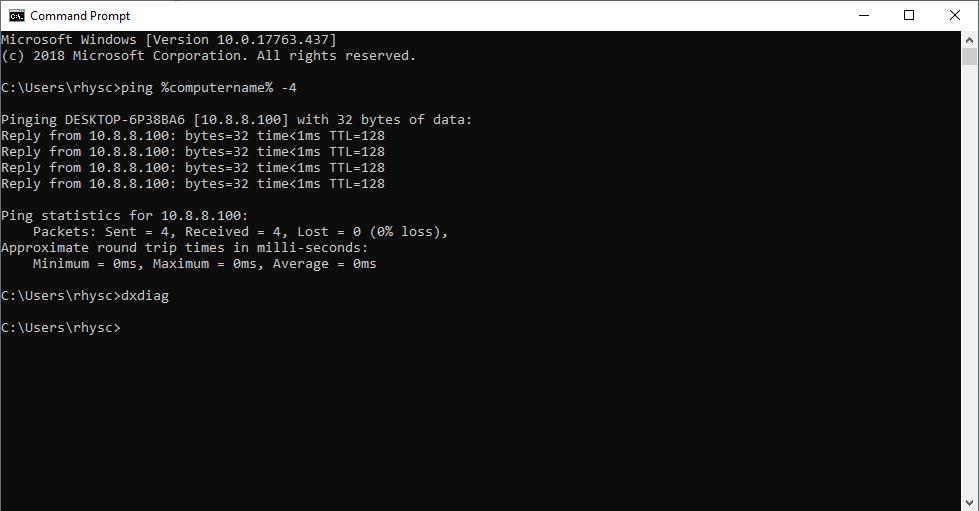

      Open CMD Prompt, then type the following command
      ping %computername% -4
      and post the output of it here

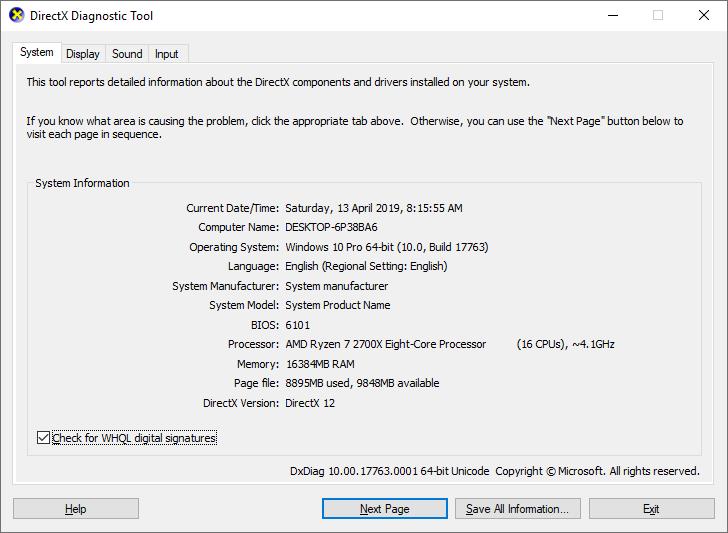

      Also, in CMD Prompt, type the following command
      dxdiag
      then post the screenshot of the 1 page and the 'Display' page here.

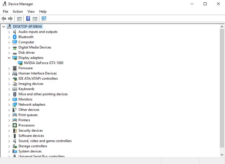

      Open up 'Device Manager' -> expand the 'Display adapters' and post the screenshot of it.

      Thanks for your response. Please see attached the requested screenshots.

      Can you try updating your Nvidia Gefore GTX 1080 graphics driver from https://www.nvidia.com/Download/index.aspx?lang=en-us
