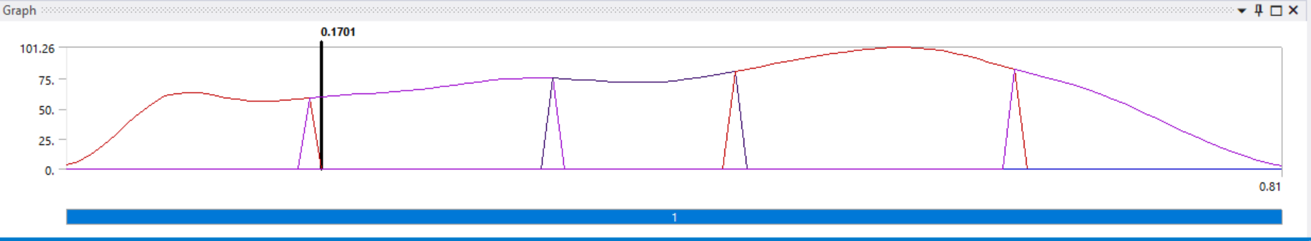

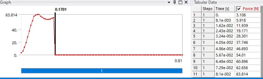

        This is what my data looks like. I've added 5 forces to simulate the effect of a varying load thats changing location after a specific duration of time. Each time the force moves to a different location I would like to have a fixed support in a new location. So for steps 1-21 I want to have a fixed support and then for steps 22-41 I want the fixed support removed from that location and moved to a different location.

      Is the data from the Gait Lab in the form of a force-time profile for each part of the foot striking the instrumented ground?  The first profile is the heel strike, the next profile is the ball of the foot strike, etc?

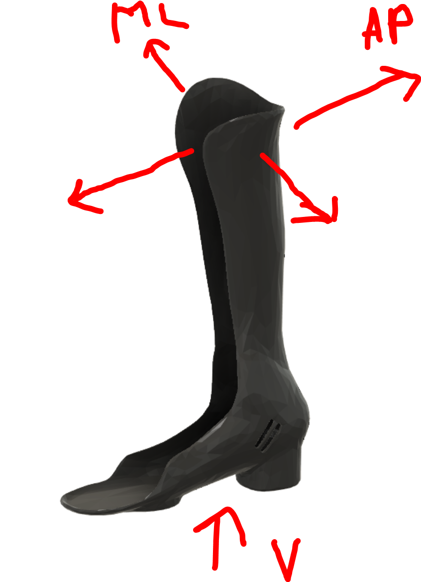

        My desired boundary conditions are as follows; Vertical, Anteroposterior and mediolateral forces applied as a force-time profile and applying a fixed support at the point where the centre of mass is at that specific point in gait.

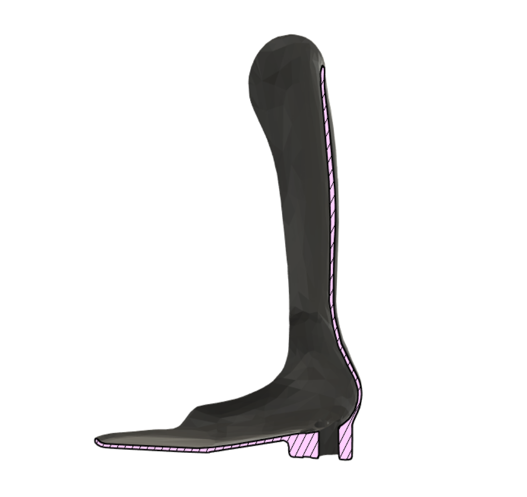

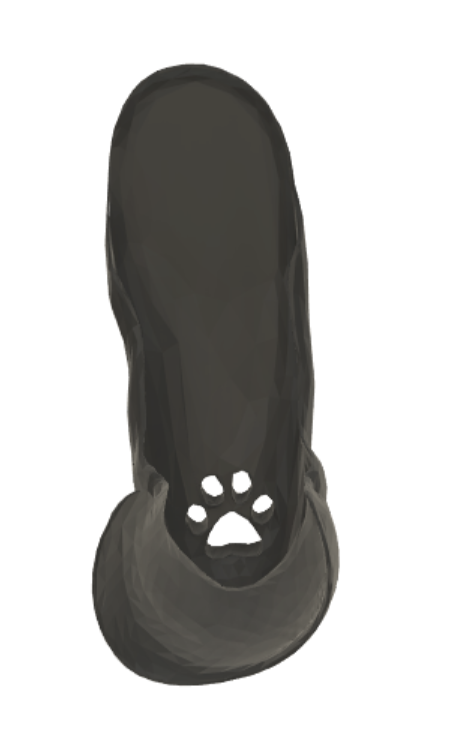

      I might have more suggestions if I could see what the AFO looked like including a section view so I could see where the foot would contact the device.
      • Sajiv Kumar
        Thank you, I would really appreciate some suggestions. I have attached the pictures of the AFO. The purpose of this simulation is to find out points where cracks are likely to occur (stress, strain, Deformation, Safety factor.. etc, etc) and also at what point of the gait cycle does it happen, so the second revision would be a model better suited to the patients gait.
        I only have reaction force data that I have split in 3 components which is Vertical, Anteroposterior and Mediolateral. Since I do not have any data for the opposing forces I thought I would ground the areas of the AFO that were in contact with the foot and the floor at the same time. It is my understanding that those sections would be stationairy. I also wasn't able to find any relevant study material or data on the loading on an AFO during the gait cycle. I would appreciate any suggestions you have, to approach this better since adding fixed supports for a specific duration is not an option anymore. If I do not add any fixed supports then I only have one force in each direction (x, y, z) and the AFO would just be in acceleration.
