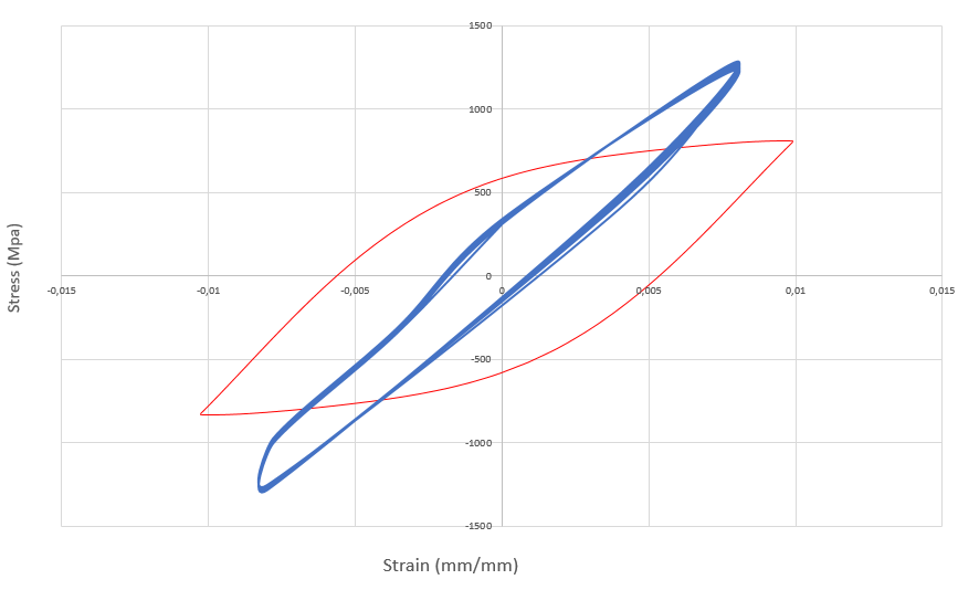

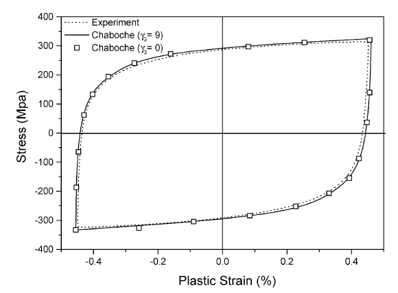

      I'm trying to compare the hysteresis loop from test with simulation resuts as shown in the example below.

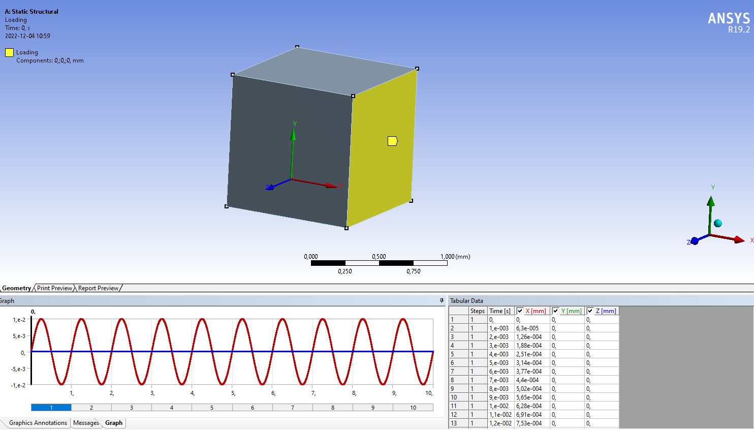

      My Simulation Conditions are :
      Cube of 1mm x 1mm x 1mm

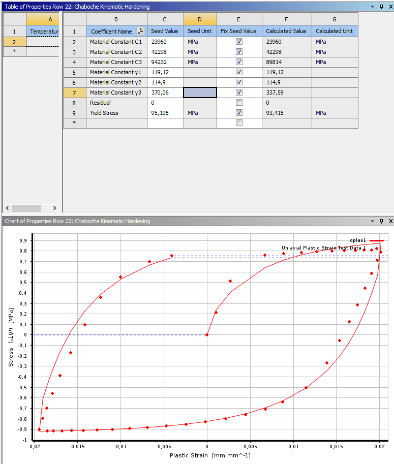

      Material : Young Modulus = 200Gpa, Poisson ratio = 0.28, Chaboche parameters in the capture below.

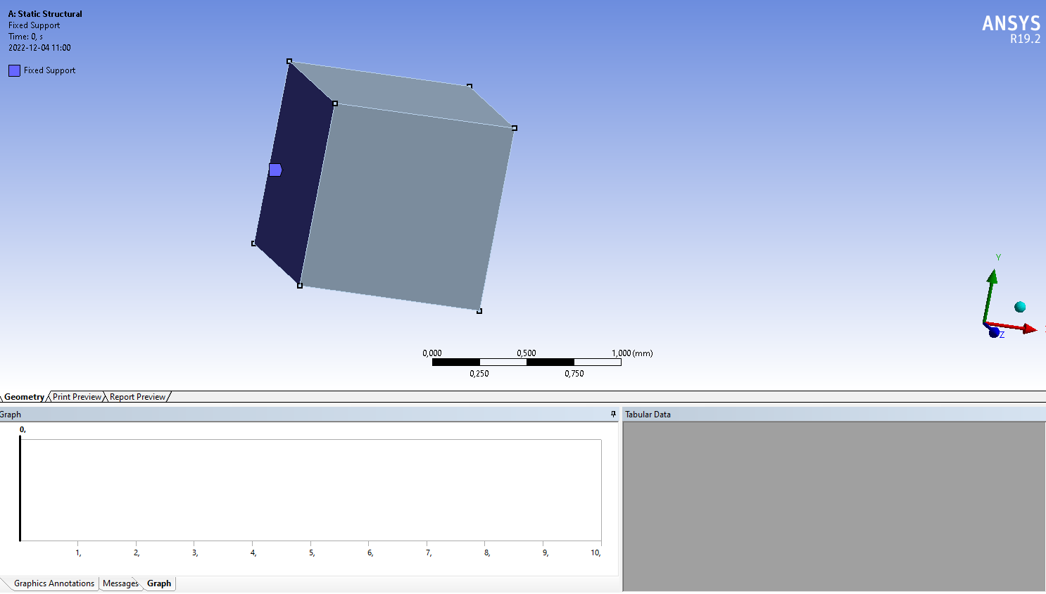

      BC : Displacement on one side and Fixed Support on the opposite side.
      Loading : sine wave with 0.01 amplitude, Frequency 1Hz.

      Which metal plasticity model did you use?  Only the elastic properties are shown.  Mike
    • MLS MLS
      Hi Mike,
      I only used elastic properties : Young Modulus of 200Gpa and Poisson ratio of 0.28.
      Should I use a plasticity model or they are already included in the Chaboche parameters C and gamma ?
      If I should use a plasticity model, can I use the Multilinear Isotropic Haredning since I have plastic deformation from the tensile test ?
      Thank you
    • mrife
      Hi MLS MLS
      Yes for what I understand of your modeling needs the Chaboche material model is added to a metal plasticity material model, and it can be multi-linear isotropic model.  See section 7.2.6 for and example here:

      I added the plasticity model but my strain is small.

      I used the nonlinear isotropic haredning with the chaboche coefficients but still have the same shape. Anyone have already correlate experimental and simulations hysteresis loop ?
